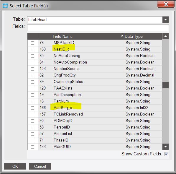

New user defined UD columns not available in BPM condition step table-field dropdown LOV
While attempting to create a BPM Data Directive on JobHead In-Transaction – on if the condition statement, it does not show two new fields created for JobHead (JobHead_UD).
I have regenerated the database, stopped and started the app pool, and stopped and started the Task Agent – twice.
I need to check if the new fields have been populated so I need to check their values in the condition block but as they’re not available for selection, I’m stuck.
Other UD _c fields appear in the dropdown but the two newest ones are not presented as an option.
The two new fields are available in a BAQ for JobHead, and they appear in the Data Dictionary for JobHead_UD.
Does anyone have any idea why one UD field on a table will appear and another will not?
