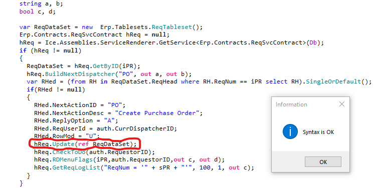

I would like to use BPM code to automatically dispatch my Requisition Send to PO stage but I hit an error as following, I had did many way to change the coding logic but still no luck.
var ReqDataSet = new Erp.Tablesets.ReqTableset();
Erp.Contracts.ReqSvcContract hReq = null;
hReq = Ice.Assemblies.ServiceRenderer.GetService<Erp.Contracts.ReqSvcContract>(Db);
if (hReq != null)
ReqDataSet = hReq.GetByID(1234);
hReq.BuildNextDispatcher("PO", out a, out b);
var RHed = (from RH in ReqDataSet.ReqHead where RH.ReqNum == 1234 select RH).SingleOrDefault();
if (RHed != null)
RHed.NextActionID = "PO";
RHed.NextActionDesc = "Create Purchase Order";
RHed.ReplyOption = "A";
RHed.ReqUserId = "PRUser";
RHed.RowMod = "U";
hReq.Update(ref ReqDataSet);
hReq.CheckToDo(auth.RequestorID);
hReq.RDMenuFlags(iPR,auth.RequestorID,out c, out d);
hReq.GetReqLogList("ReqNum = '" + sPR + "'", 100, 1, out c);

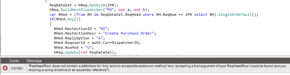

I think just the term of .Any() is not found and need to search which reference should use, the definitely able to work in screen customization but i think is not working in BPM custom code.

I encounter the error come from the line when I try to update my dateset, something been null and unable to update to get through.
I would do it manually, tracing the Update dataset parameters. Then make sure when you do your code you have the same elements in your ReqDataSet set. My guess is one of the fields in your ReqDataSet is null and the BO is expecting a value.
Edit: On second thought, the error seems to stem from ReqHeadBeforeUpdate. So maybe there’s a field missing in a RHead element.

First, more context will be needed, is this a method or data directive, what table\method, pre\post\intrans\standard
It looks to me the issue is happening in base code. Are you modifying a record before Epicor is trying to change it?
Regarding the Any(), it’s great. It’s a feature of Linq and Linq is configured by default in BPMs so you are good there. You could potentially start simplifying.
for example, do you still get the error if you comment our everything below RHed != null?
