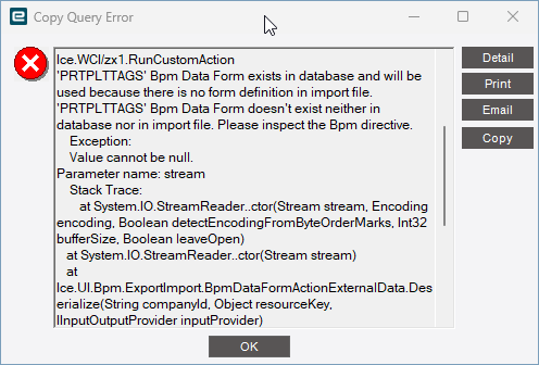

On a side note Copy Query no longer works with a BPM Form. Probably because the copy query once again gets a new GUID and sees that it doesnt exist.
