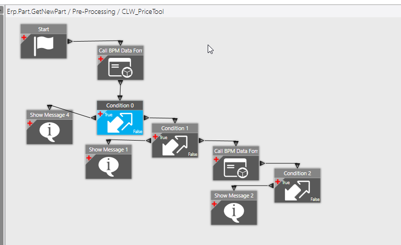

Hi Thanks for a reply
I began designing the BPM Flow and below is a screen shot
For the time being where you see Show Message - this is where I want to call a baq to pass information and return a result.
Using conditions I have been able to flow to the next question using another Data form and so on, but I don’t knw if im over complicating it, Im just really stuck on how to run ideally my dashboard passing the parameter through, or a baq
2nd flow then asks
Does this make it clearer?
I think it depends on what data you are getting back and what you want to do with it (display on BAQ data form ? Or modify the main table you are dealing with). I dont think you can run a BAQ from a BPM just using widgets but there are a number of setter widgets to update fields or tables based on a query (not used them myself but there designer does look a lot like the BAQ designer).

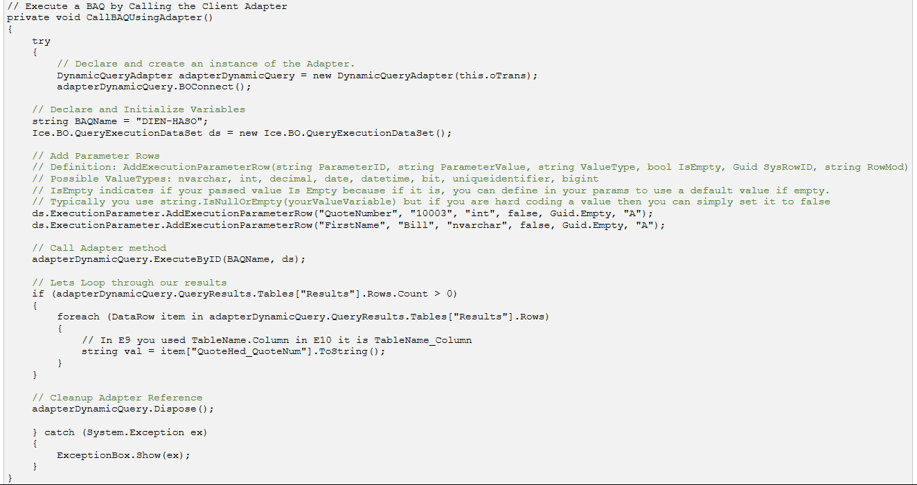

You can run a BAQ but its not nice. For example, you could display BAQ results on the BPM data forms themselves but you’d need to add a customisation and add some code. You may be able to adapt the following code:
‘’'cs
// Execute a BAQ by Calling the Client Adapter
private void CallBAQUsingAdapter()
try
// Declare and create an instance of the Adapter.
DynamicQueryAdapter adapterDynamicQuery = new DynamicQueryAdapter(this.oTrans);
adapterDynamicQuery.BOConnect();
// Declare and Initialize Variables
string BAQName = "DIEN-HASO";
Ice.BO.QueryExecutionDataSet ds = new Ice.BO.QueryExecutionDataSet();
// Add Parameter Rows
// Definition: AddExecutionParameterRow(string ParameterID, string ParameterValue, string ValueType, bool IsEmpty, Guid SysRowID, string RowMod)
// Possible ValueTypes: nvarchar, int, decimal, date, datetime, bit, uniqueidentifier, bigint
// IsEmpty indicates if your passed value Is Empty because if it is, you can define in your params to use a default value if empty.
// Typically you use string.IsNullOrEmpty(yourValueVariable) but if you are hard coding a value then you can simply set it to false
ds.ExecutionParameter.AddExecutionParameterRow("QuoteNumber", "10003", "int", false, Guid.Empty, "A");
ds.ExecutionParameter.AddExecutionParameterRow("FirstName", "Bill", "nvarchar", false, Guid.Empty, "A");
// Call Adapter method
adapterDynamicQuery.ExecuteByID(BAQName, ds);
// Lets Loop through our results
if (adapterDynamicQuery.QueryResults.Tables["Results"].Rows.Count > 0)
	foreach (DataRow item in adapterDynamicQuery.QueryResults.Tables["Results"].Rows)
		// In E9 you used TableName.Column in E10 it is TableName_Column
	    string val = item["QuoteHed_QuoteNum"].ToString();
// Cleanup Adapter Reference
adapterDynamicQuery.Dispose();
} catch (System.Exception ex)
	ExceptionBox.Show(ex);

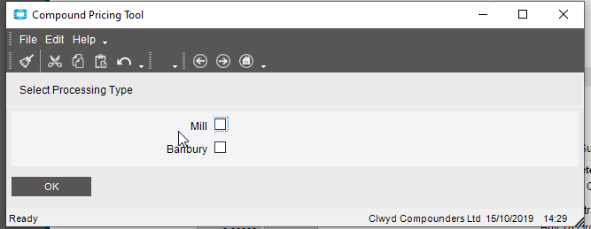

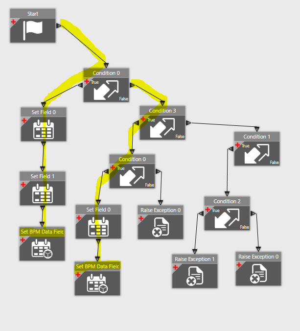

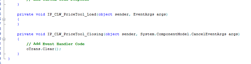

Thanks for all your help.
My development is almost complete. I have bpmdata forms opening depending on what was answered in the previous bpmdata form and its flowing really well.
My last issue is that on load of the BPM data forms they remember the last data entered when it was last run. I’d like to clear this data on some fields on load or on close. Everythign ive tried so far does work. Example is below
This is the bpmform
The BPMData form
:+1:
why not clearing your Character01 variable on the BPM itself “set BPMCalConext…to blank” after using it in whatever logic you are running
Hi thanks for reply- I could clear all within the bpm before the flows begin I guess, I wouldn’t want to clear within the flow as it utilises them across different forms. Ill give it a go. Thanks!
every time you run your BPB will go through one of the possible designed paths (each condition is branched Yes and No) , you should be able to clear your variable at the end of each of these paths after using it in your logic, this should not affect your design.
