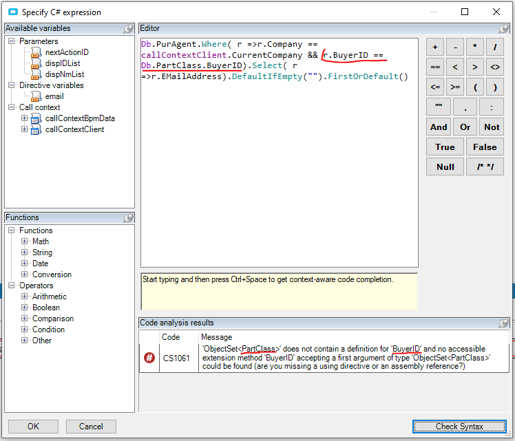

I am building a BPM that will send out an email to our purchasing agent whenever a requisition is made. I am trying to link the PurAgent table and the PartClass table so that I can pull in the email for our purchasing agent. the error I’m running into says that the partclass table does not have a BuyerID.
However, I clearly see the BuyerID on in the part class table. Any ideas on why this is happening?

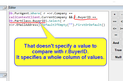

Db.PartClass.BuyerID isn’t a specific value. Which PartClass do you want the BuyerID for?
Try creating a variable to hold BuyerID, and assign it with a SetFiled widget. In the set field’s expression, you have something like:
Db.PartClass
  .Where(r => r.Company = callContextClient.CurrentCompany
    && r.ClassID == !reference to the parts Class!)
  .select (r=>r.BuyerID)
  .DefaultifEmpty("")
  .FirstOrDefault()
Then use that variable in your expression for getting the email address.

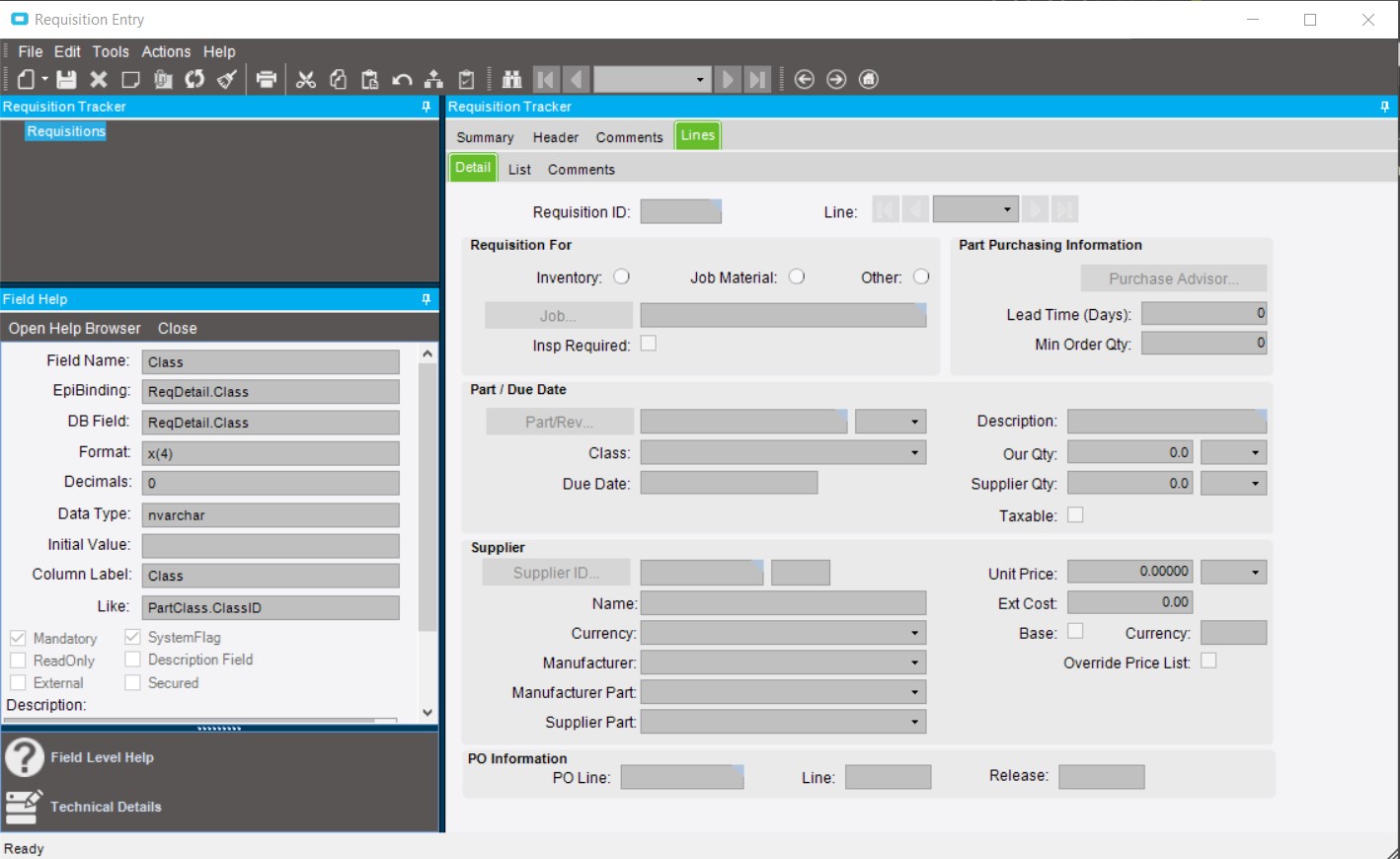

OH! Okay, so I think I get what you mean. In this case I want to run the ReqDetail Class against the Part class and get the buyerID that way. Then run the BuyerID against the the PurAgent Table BuyerID to get the buyer Email. With that logic in mind, how do I specify the curent ReqNum and ReqLine from the ReqDetail table?
I am guessing you want check this field?

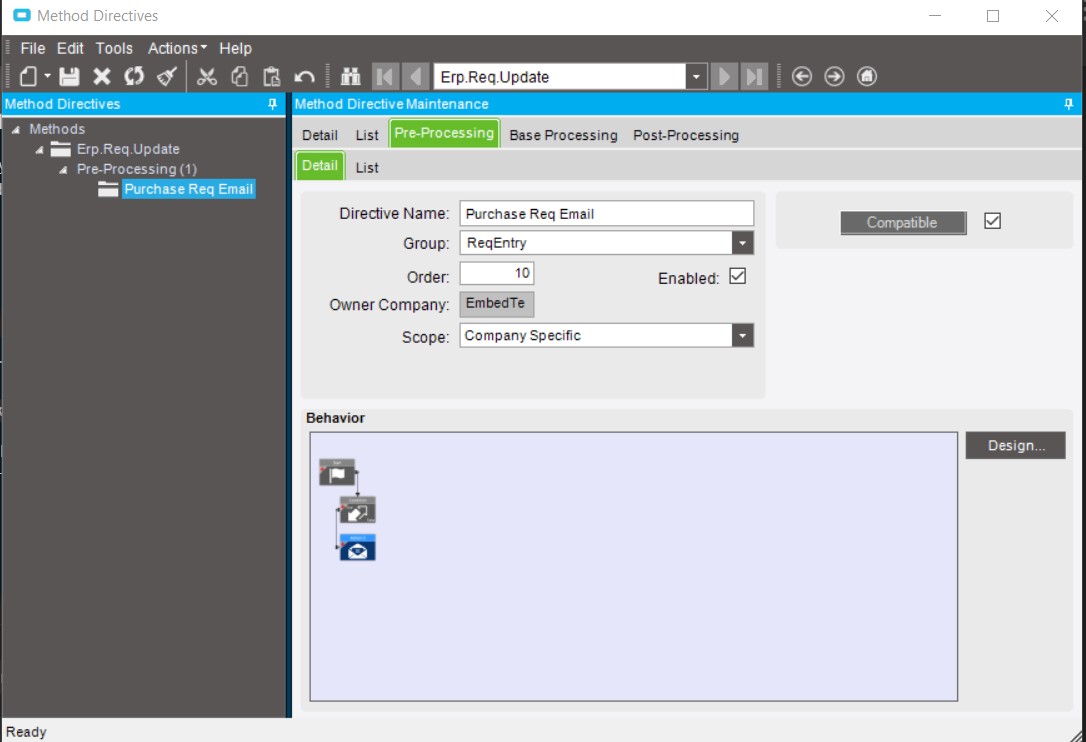

We email purchasing on the update method.
There is an if check that determines when to create the email. Wonder if that will work for you?

I’ve been trying that and have been met with two results. Firstly, if I use pre-processing it will lock me out of entering new lines on the Req entry screen. Secondly, if I use post-processing it won’t do anything. The condition I’m using is Req Head Status Type and set it to be equal to “P” for pending. Would you mind sharing what condition you’re using?
