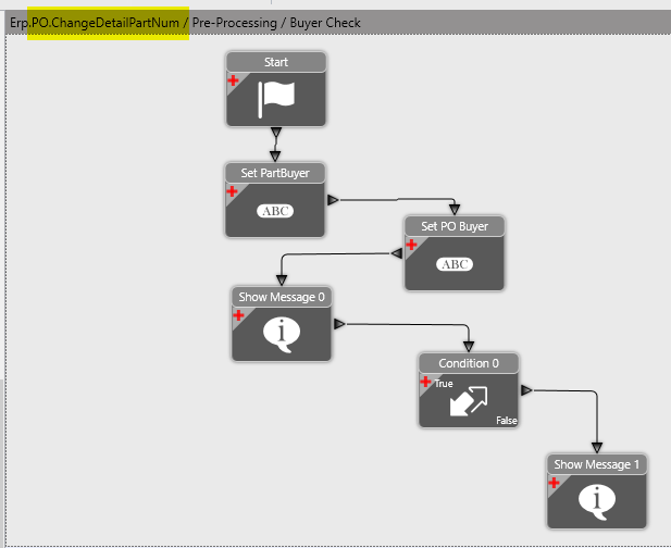

Here’s the BPM (to get you started)
  1. Two variables: ApprovedBuyer and CurrentBuyer
  2. Set Variable/Argument widget to set ApprovedBuyer
Db.PartPlant
  .Where( r =>r.Company == callContextClient.CurrentCompany && r.PartNum == NewPartNum && r.Plant == callContextClient.CurrentPlant)
  .Select( r =>r.BuyerID).DefaultIfEmpty("").FirstOrDefault()
  1. Set Variable/Argument widget to set CurrentBuyer
Db.POHeader.Where( r =>r.Company == callContextClient.CurrentCompany && r.PONum == ttPODetailRow.PONUM)
  .Select( r =>r.BuyerID )
  .DefaultIfEmpty("Not Found").FirstOrDefault()

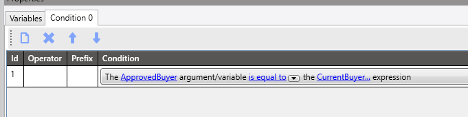

  1. Condition to see if they are equal.

I can get the logic to work to check the approved vs current buyer but what do I need to do in the BPM to stop the user from proceeding with saving/creating the PO? I can get an info message to appear but there needs to be a “cease & desist/can’t proceed with this” widget?
Use a “Raise Exception” Widget. It works just like a “Show Message”, but stops the BO method from completing.

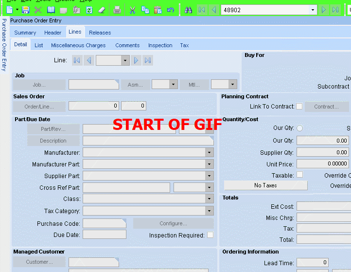

Here’s a GIF of it in action:
Note that it clears the Part Number field too
