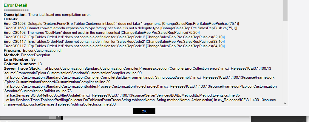

I’m using the following code (switched the ’ in CustNum)-
var customer = (from a in this.Db.Customer
where a.CustNum == “CustNum”
select new { a.SalesRepCode,a.SalesRep2_c,a.SalesRep3_c }).FirstOrDefault();
var orderHed = (from a in this.Db.OrderHed
where a.OrderNum == 1
select a).FirstOrDefault();
OrderHed.SalesRepCode1 = customer.SalesRepCode;
OrderHed.SalesRepCode2 = customer.SalesRep2_c;
OrderHed.SalesRepCode3 = customer.SalesRep3_c;
But I’m getting the following errors:
Edit -
Is this throwing the last three errors because OrderHed.SalesRepCode1 - 3 are just binded fields on the Order Entry screen? They’re not true DB fields…
You are correct these are not valid db fields. These fields are dumped into the OrderHed.SalesRepList, They are ampersand separated. Also I dont see the other SalesRepFields in the customer table.

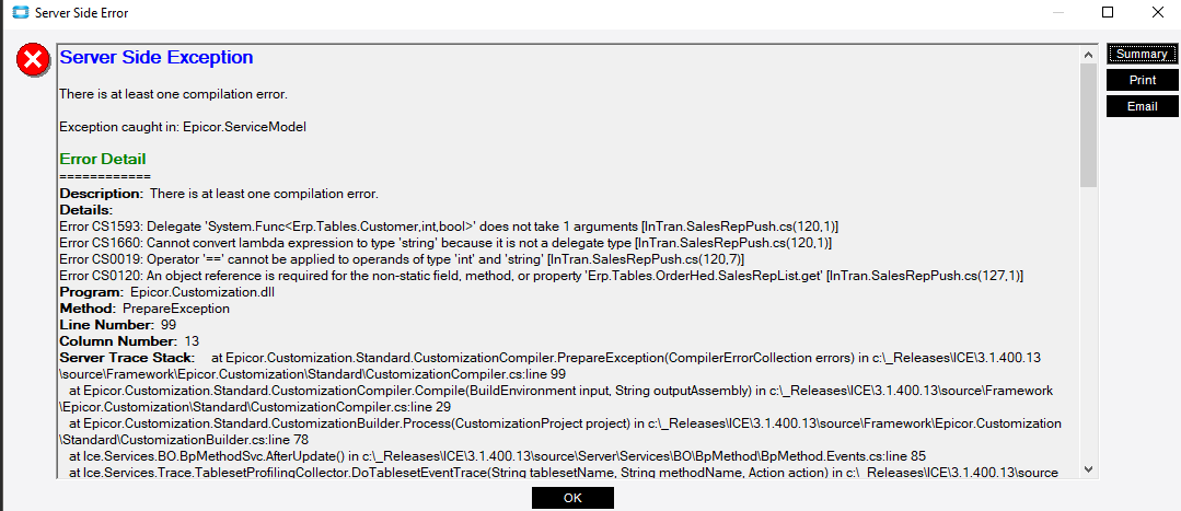

I tried that (but switched where a.CustNum == ‘CustNum’ to read like where a.CustNum == “CustNum” - otherwise I was getting an error about the characters being too literal or something similar…)
Now I’m getting the following errors -

Use Data Directive : OrderHed
Erp.Tables.Customer Customer;
var ttOrderHed_xRow = (from ttOrderHed_Row in ttOrderHed
where ttOrderHed_Row.RowMod == IceRow.ROWSTATE_ADDED || ttOrderHed_Row.RowMod == IceRow.ROWSTATE_UPDATED
select ttOrderHed_Row).FirstOrDefault();
if (ttOrderHed_xRow != null)
       Customer = (from Customer_Row in Db.Customer
            where Customer_Row.CustNum == ttOrderHed_xRow.CustNum
               && Customer_Row.Company == Session.CompanyID
                select Customer_Row).FirstOrDefault();
       if (Customer != null)
                ttOrderHed_xRow["SalesRepCode1"] = Customer.SalesRepCode;
