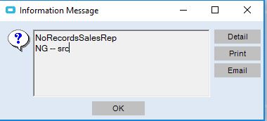

Not getting any Linq errors… this is a plus.
But I still can’t seem to return the data I am looking for.
I even passed the value of src to a popup… so i know it is getting data.

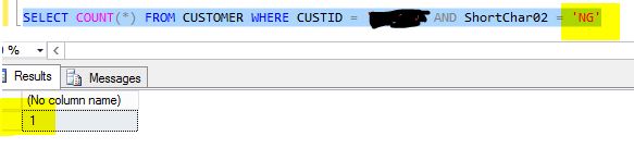

I can query the table in sql to verify that there should be a record from the Linq query,
But my second query must be coming back null for some reason.

Customer table does have NG in ShortChar02 for the CustID i’m testing.
NG%20Query

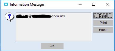

I dumped the callContextBPMData and found your post on pushing our a message in a BPM (thanks).
I swapped the commented line to use the SalesRepCode to in the where clause and ran it successfully.
I toggle back to try use the src variable in the where clause and came up with "NoRecordsSalesRep’ Again
   Erp.Tables.SalesRep SalesRep = null;
   string RepEMail = "";
var ttCustomer_xRow = (from ttCustomer_Row in ttCustomer
    where ttCustomer_Row.RowMod == "U"
    select ttCustomer_Row).FirstOrDefault();
if (ttCustomer_xRow != null)
    //string src = ttCustomer_xRow["ShortChar02"].ToString();
    string src = "NG";
    callContextBpmData.ShortChar02 = src;
    var SalesRep_xRow = (from SalesRep_Row in Db.SalesRep
        where SalesRep_Row.Company == Session.CompanyID
        && SalesRep_Row.SalesRepCode == ttCustomer_xRow.SalesRepCode
        //&& SalesRep_Row.SalesRepCode == src
        select SalesRep_Row).FirstOrDefault();
     if (SalesRep_xRow != null)
        RepEMail = SalesRep_xRow.EMailAddress;
        this.PublishInfoMessage(RepEMail, Ice.Common.BusinessObjectMessageType.Information, Ice.Bpm.InfoMessageDisplayMode.Individual, "FirstVar","SecondVar");
      else
        RepEMail = "NoRecordsSalesRep";
        //RepEMail = SalesRep_xRow.EMailAddress;
SalesRepEMail
