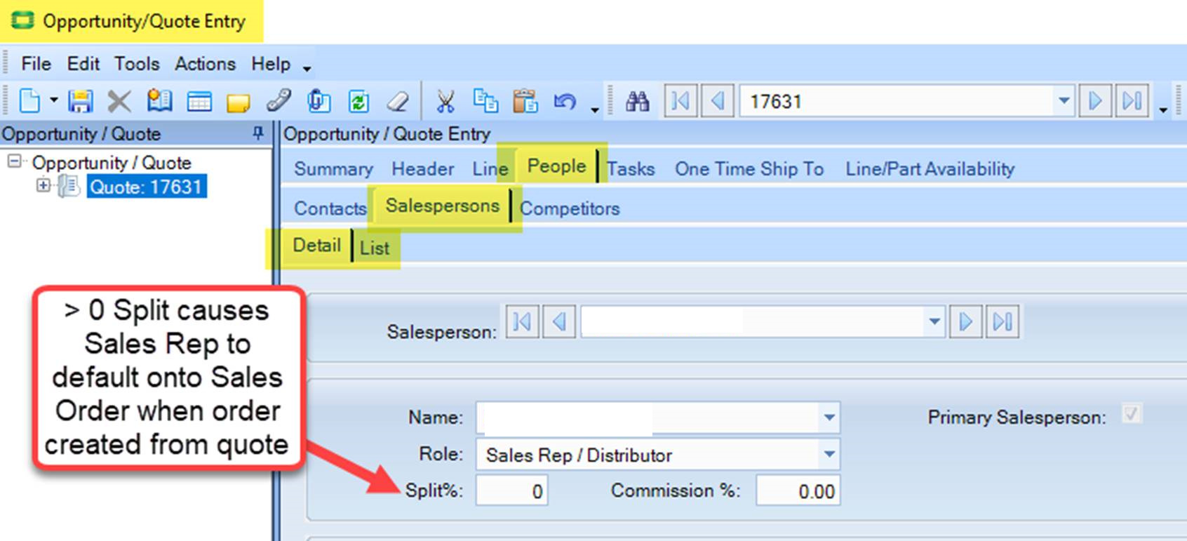

We had some question on the functionality here a little while back. We are on 10.1.600, so I’m not sure if same in your version. Anyway, we found that if a “Split” value greater than 0 (100 typical percent for us) was entered on the quote People/Salespersons/Detail tab (screenshot below) then the sales rep/commission came across onto the sales order. Based on this, I think you might want to ensure that you actually need this bpm. Perhaps the system already does what you need when split is completed.
Nancy
One other thing to watch out for, I noticed that the Quote will get more than one sales rep (i.e., viewable via list view under People / Salespersons / List tab) if the sold to is different from the ship to, and there are sales reps assigned to both address in the customer master. In cases like this, we told our people to ensure that the value for Split is only assigned to the ship to rep, which is how we pay commission.

Regarding the Split % tidbit - Nancy is correct that setting to 100 in Quote will push the correct Salesrep into the Sales Order (I ended up setting Split % inside a Customization in the post I shared).

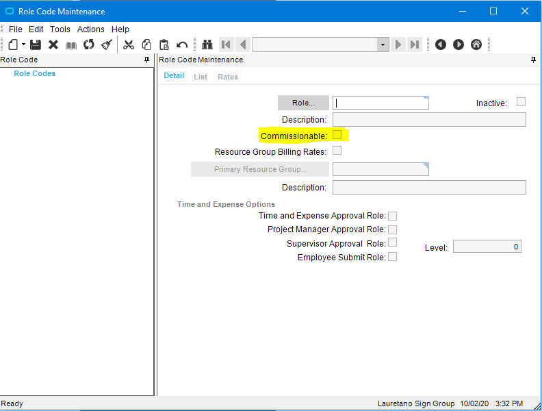

This absolutely worked, and setting it automatically is for the Work Force Role Codes
