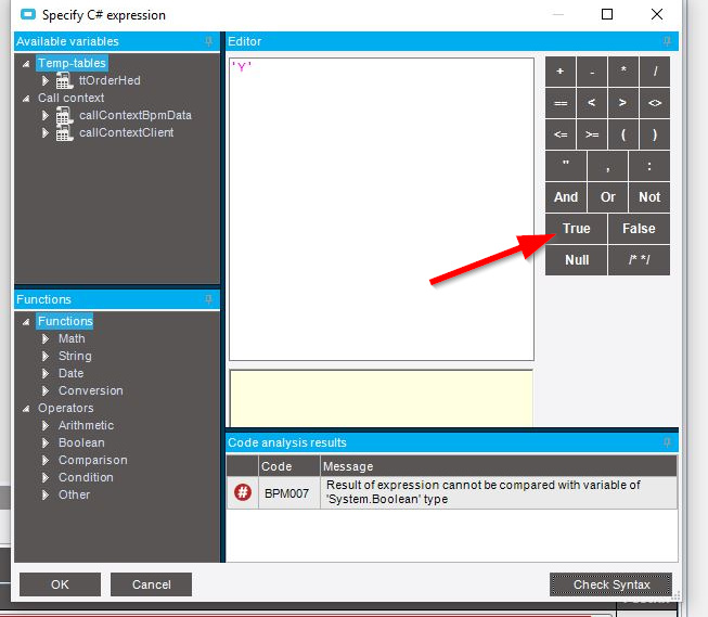

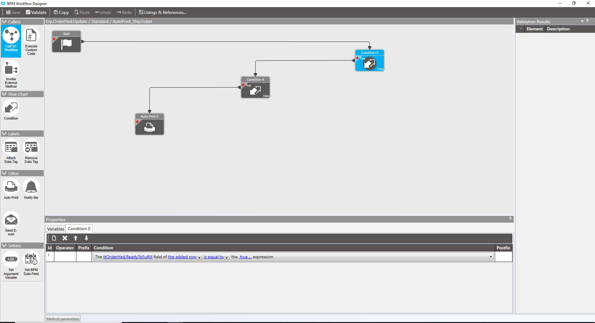

I am creating a BPM that will print from the Ready To Full checkbox in OrderHed is checked/equals yes/true. The condition i am trying to set is ttOrderHed.ReadyToFulfill field of the changed row is equal to ‘Y’ expression. However, it is giving me an error of Result of Expression cannot be compared with variable of ‘System.Boolean’ type.
My goal is to have thing sprint based on this checkbox being checked and specified CustNum.

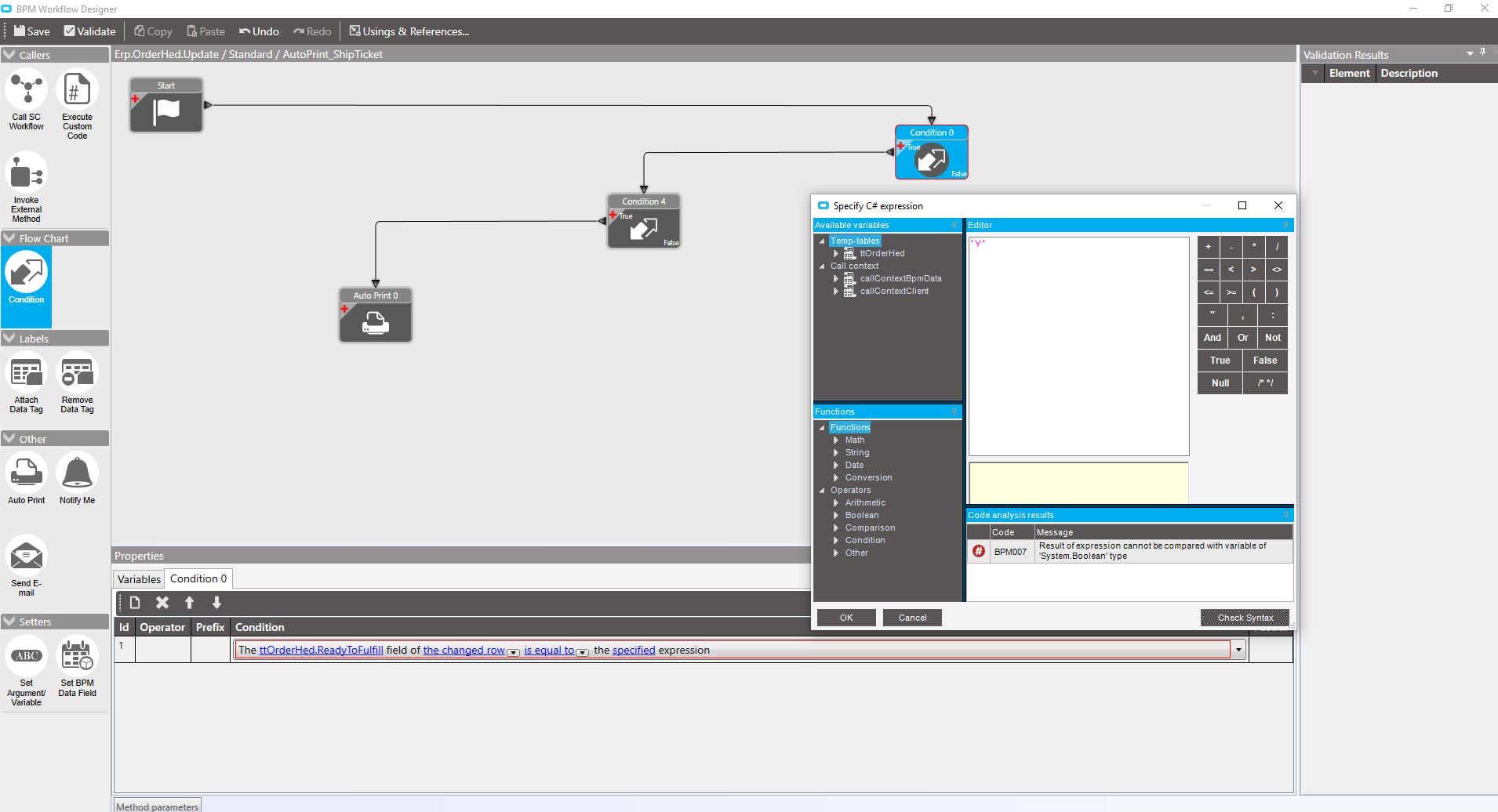

Instead of typing 'Y' (whic is a string), use 1 (which is the same as clicking the true button in the toolbox area.
Last question: I changed it accordingly and it worked, sorta. The order imported just fine and then the BPM was triggered. Except it doesn’t see the ordernum. Here is the error.

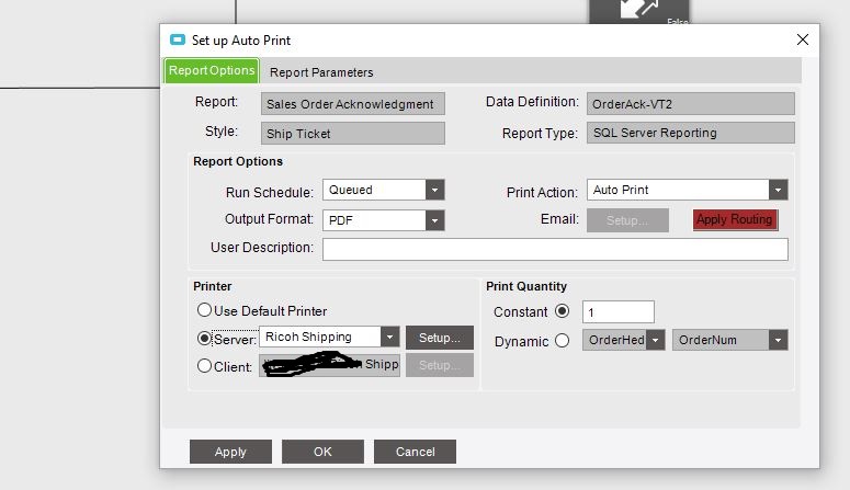

Double check the setup of the Auto Print widget. I always have to experiment a lot, as I can never remember the details
Did you change the report settings in the auto rpt widget to set the ordernum = OrderHed.OrderNum?

Everything look right in the Report Options tab of the Set up Auto Print dialog?
I see you have the ArchiveCode set to 1 (that’s in days). Does the report appear in the Reports tab of the System Monitor?
I have imported two orders. What printed out was two Ship Tickets for the first order. In System Monitor it shows only the two ship tickets for order 1, and does not show (or print) anything for order 2.
The OrderAck report accepts a list of Orders to print. Try playing with the OrderList parameter instead of the OrderNum Parameter.
I had thought about that but wasn’t sure how it functioned. Time to check into that!
@ckrusen So, the list worked great! The first order sent didn’t print, gave an error instead. But he second one did print! And only one copy!!
