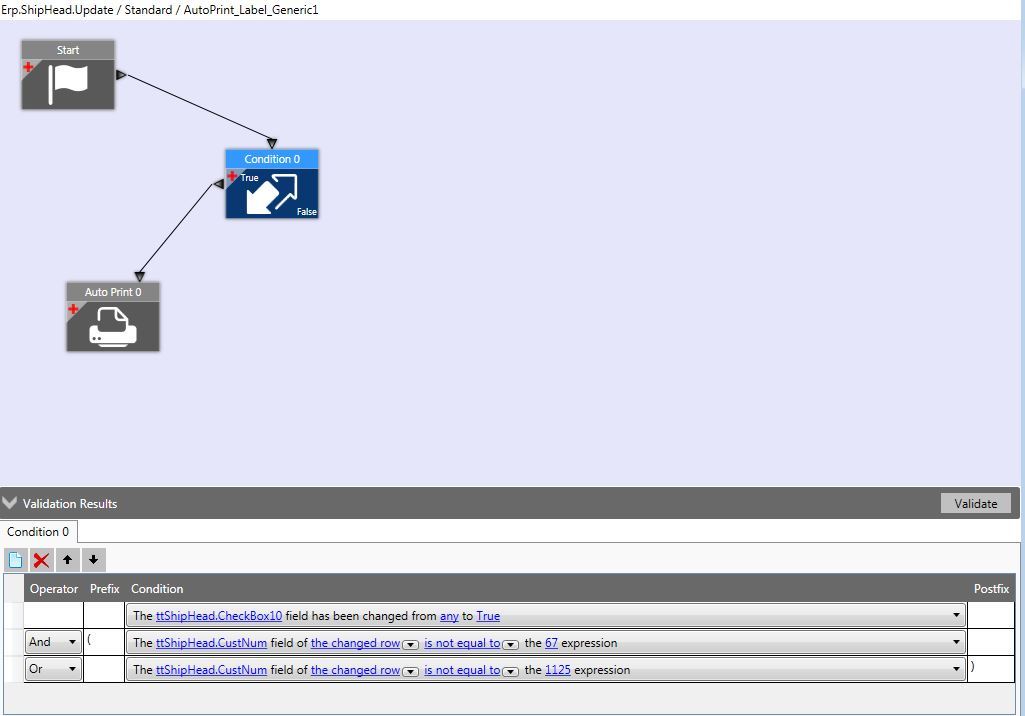

Could you paste in a screenshot of your designer view so I can see from start - finish the logical flow?
What I have below works sans the auto-print object. The first condition checks if equal to Customer A and if the UD checkbox was flagged. If true it fires a custom code object that displays a message that path 1 was chosen. If the first condition is false it checks the second condition that looks at the UD field being checked and two different customer numbers. This works perfectly and makes me wonder if the auto-print object is not setup correctly vs. the conditions. All of this assumes you have it setup kind of the same.
Another wrinkle. I just tested with only one customer excluded for the generic label and the generic label didn’t print. This is the desired action. The problem occurred when I added a second customer to exclude. Once I added the second customer, the generic label printed again. Basically, my goal is to have all the customers listed here that have customer specific formatted labels so that if it’s not one of these customers, the generic box label will print. Perhaps my syntax for the prefix/postfix parentheses is incorrect?
[cid:image001.jpg@01D2B3BF.9B4E6FA0]
You should have AND instead of OR in the third line.
That fixed it. I appreciate the assist!
