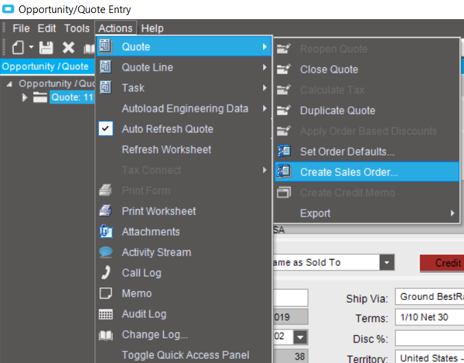

I’m working on BPM (Method Directive | Pre-processing) . Business Object used - Quote and Method used - createOrder. Whenever a new sales order is created I’m getting the SONumError SONumError2 mail with required data except the new sales order number. The number always shows 0. I have attached screenshot for reference.

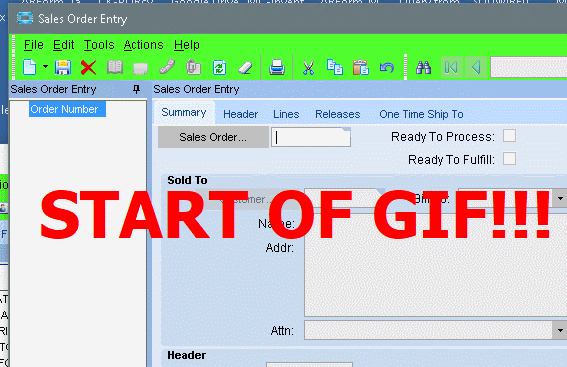

When a new order is first created - and before it is saved - it is assigned OrderNumber 0.
You can see this in order entry when you select New Order.
Edit
Even after entering data into “order 0”, it stays as 0 until it is saved. And there’s no data in the DB for order 0. This is why two people can simulatneously be working on “order 0”. Think of it as an indicator of “not yet created”.
NewOrderZero
But Im working on Opp/Quote form.

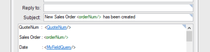

  1. Capture the QuoteNum in the pre-proc
  2. Create the email in the Post-Proc.
  • param orderNum will have the Order number
  • BPMContext.Number01 will hold the quote number
(Here they are in an example message box)
Hint: Build the date as a string in the Pre-Proc, and assign it to BPMContext.Character01. Then use that in the post proc to show a prettier date (no time part)
