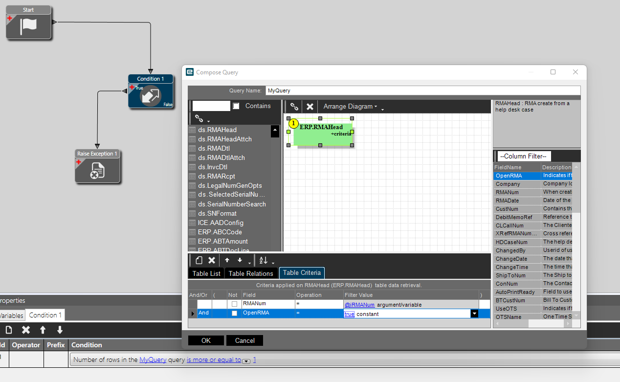

Is there any reason you aren’t just using the condition where you make a query and count the rows? That seems like it would be a lot easier.
No reason other than not being aware of this option. I will try this out and get back to you on Monday. Thanks
@Banderson Thanks for the tip, that worked out for me.
have you made it work? I have the same task but I can not figureout how to do this on Erp.RMAProc.RMACreditAdd singe during proces dataset are empty.
Solved this like that, by using conditional query and “iRMANum” parameter
