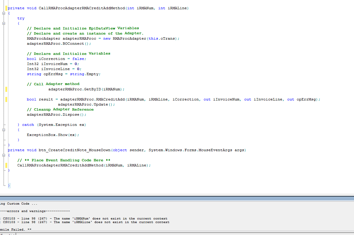

@Arul Nothing is happening when i click the button after putting this code in.
See below full code:
// Custom code for RMAProcForm
// Created: 12/05/2021 10:04:28
extern alias Erp_Adapters_SalesOrder;
extern alias Erp_Contracts_BO_RMAProc;
extern alias Erp_Contracts_BO_SalesOrder;
extern alias Erp_Contracts_BO_Customer;
extern alias Erp_Contracts_BO_ShipTo;
extern alias Erp_Contracts_BO_Part;
extern alias Erp_Contracts_BO_OrderRelSearch;
extern alias Erp_Adapters_RMAProc;
using System;
using System.ComponentModel;
using System.Data;
using System.Diagnostics;
using System.Windows.Forms;
using Erp.Adapters;
using Erp.UI;
using Ice.Lib;
using Ice.Adapters;
using Ice.Lib.Customization;
using Ice.Lib.ExtendedProps;
using Ice.Lib.Framework;
using Ice.Lib.Searches;
using Ice.UI.FormFunctions;
public class Script
// ** Wizard Insert Location - Do Not Remove ‘Begin/End Wizard Added Module Level Variables’ Comments! **
// Begin Custom Code Disposal
// End Custom Code Disposal
private void CallRMAProcAdapterRMACreditAddMethod(int lRMANum, int lRMALine)
try
// Declare and Initialize EpiDataView Variables
// Declare and create an instance of the Adapter.
RMAProcAdapter adapterRMAProc = new RMAProcAdapter(this.oTrans);
adapterRMAProc.BOConnect();
// Declare and Initialize Variables
bool iCorrection = false;
Int32 iInvoiceNum = 0;
Int32 iInvoiceLine = 0;
string opErrMsg = string.Empty;
// Call Adapter method
adapterRMAProc.GetByID(lRMANum);
bool result = adapterRMAProc.RMACreditAdd(lRMANum, lRMALine, iCorrection, out iInvoiceNum, out iInvoiceLine, out opErrMsg);
adapterRMAProc.Update();
// Cleanup Adapter Reference
adapterRMAProc.Dispose();
} catch (System.Exception ex)
ExceptionBox.Show(ex);
private void btn_CreateCreditNote_Click(object sender, System.EventArgs args)
EpiDataView edvRMADtl = ((EpiDataView)(this.oTrans.EpiDataViews[“RMADtl”]));
for (int i = 0; i < edvRMADtl.dataView.Table.Rows.Count; i++)
int lRMANum = Convert.ToInt32(edvRMADtl.dataView.Table.Rows[i][“RMANum”]) ;
int lRMALine = Convert.ToInt32(edvRMADtl.dataView.Table.Rows[i][“RMALine”]) ;
bool recSelected;
string whereClause = “RMANum = '” + lRMANum + “’ and RMALine = '” + lRMALine + “’” ;;
System.Data.DataSet dsARInvcDtlSearchAdapter = Ice.UI.FormFunctions.SearchFunctions.listLookup(this.oTrans, “ARInvcDtlSearchAdapter”, out recSelected, false, whereClause);
if (recSelected)
else
CallRMAProcAdapterRMACreditAddMethod(lRMANum, lRMALine);
oTrans.Refresh();
