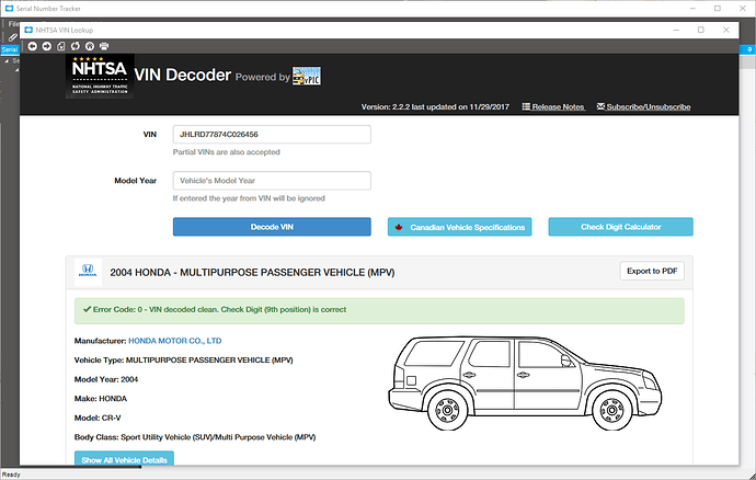

Let’s assume you are dealing with Vehicles and would like to add a button to the Serial Number Tracker form that shows details for the loaded VIN (Serial Number) from NHTSA.
// Assuming you know how to add a button and a Click event via Wizards
private void btnVINDetails_Click(object sender, System.EventArgs args)
   EpiTextBox txtSerialNumber = (EpiTextBox)csm.GetNativeControlReference("46567b2e-6bc0-4967-be35-a0ec6843838f");
   string url = "https://vpic.nhtsa.dot.gov/decoder/Decoder?vin=";
   LaunchURL(url + txtSerialNumber.Text, "NHTSA VIN Lookup");
Sample URLs:
Fedex Tracking:
https://www.fedex.com/apps/fedextrack/index.html?tracknumbers=_YOUR_VALUE_
USPS Tracking:
https://tools.usps.com/go/TrackConfirmAction?tLabels=_YOUR_VALUE_
UPS Tracking:
https://wwwapps.ups.com/WebTracking/track?track=yes&trackNums=_YOUR_VALUE_
NHTSA VIN Lookup:
https://vpic.nhtsa.dot.gov/decoder/Decoder?vin=_YOUR_VALUE_
