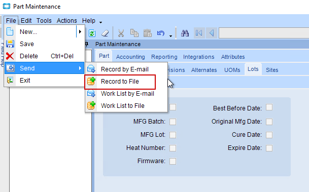

Sure thing use the Send Record to File feature
This creates an XML that is understood by the epicor client which launches the specified record in the fat client. You’ll have register .sysconfig files in the workstation to launch with Epicor.exe but it should work.
Then from your interface you generate an equivalent XML file and have your user “Open” it

In the rich client you can perform a File->Send which will create a .sysconfig file. These files can be crafted to contain the record data to open the relevant form with the data prepopulated. I would expect if you are wanting to do this via the web you may need to get the form to open in the Epicor Light Weight Client. I have not done this, but do it for Case management in E9 by the file as an attachment in a BPM email.

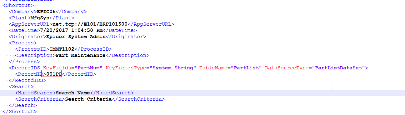

To add to Jose’s comment. I use a template XML file and then do a replace on the tags that I need to update. I store the template in the Epicordata directory.
Here is a sample but it is for E9 Case management.Case_Entry_Template.mfgsys.xml (8.8 KB)

You save a copy of the “sample” xml file which looks like this and you store it on the server
But replace the RecordID with a easily unique “template” flag for example {REPLACE_ME_AT_RUNTIME}
Then when the user clicks “Launch In Epicor” you simply read the XML File in do a replace of your {REPLACE_ME_AT_RUNTIME} with the PartNum that you want and output that file down to the browser which will prompt you to “Save” or “Run” if the user clicks “Run” it will launch Epicor proper.
