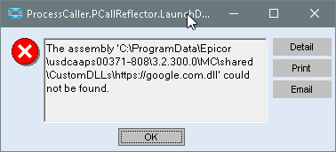

I Switched to trying it as code in a customization of a BPM Form but ended up getting:
:thinking:
Maybe the LaunchForm() isn’t the way to go…

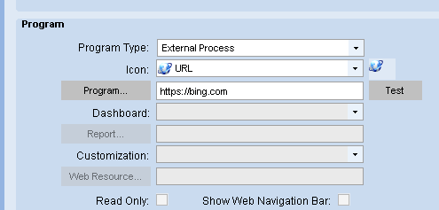

I spoke too soon! I had the Menu set as a URL Link. I changed it to External process:
Now when the code in the BPM form runs, it launches the browser and opens the page specified in the menu item.
Now you’ll have to see if updating the Menu table via code (changing Menu.Program to point to your desired URL), will work, or if its that annoying “menus are only loaded during startup”, and changes don’t take effect until the next tim you launch the client.

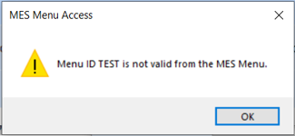

I created a menu item in the regular client to open the URL and was trying to have the customization on the BPM form open that menu item. Are we not able to call a menu from MES to the regular client like that? I’m getting this error.
I’m guessing that you’d need to add the menu item to the MES menu to. We don’t use MES, so I’m not sure if it can be added as a process menu.

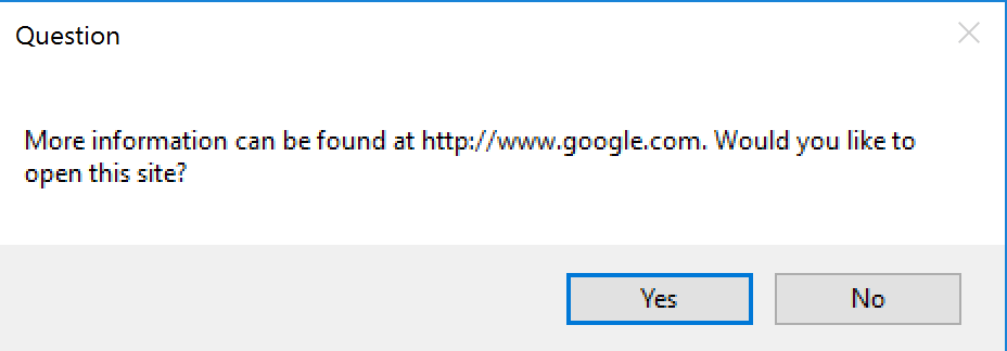

You could do it in the BPM Form Customization or just return it to the User Interface that was calling the BPM. Let’s say the BPM passed back a CheckBox that indicated to display the message and then a Character field that becomes returnURL below. Basic example without BpmData hooks.
DialogResult dialogResult = MessageBox.Show(string.Format("More information can be found at {0}. Would you like to open this site?",returnURL), "Question", MessageBoxButtons.YesNo);
		if(dialogResult == DialogResult.Yes)
			System.Diagnostics.Process.Start(returnURL);

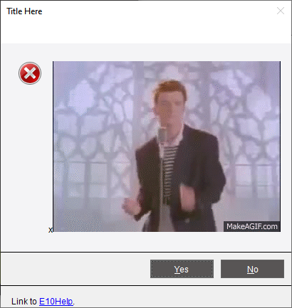

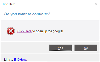

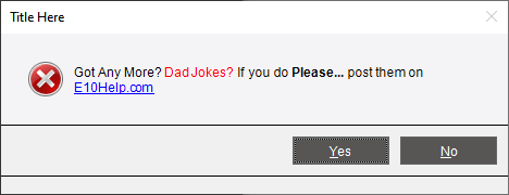

Here is if you want to get fancy :slight_smile: you can take out sections you dont want and even further customize it and use full html in the text such as <h1> etc.
Infragistics.Win.UltraMessageBox.UltraMessageBoxManager.Show(
	new Infragistics.Win.UltraMessageBox.UltraMessageBoxInfo {
		Caption = "Title Here",
		TextFormatted = "<a href=\"https://www.google.com/\">Click Here</a> to open up the google!",
		Style = Infragistics.Win.UltraMessageBox.MessageBoxStyle.Standard,
		HeaderFormatted = "<i>Do you want to continue?</i>",
		FooterFormatted = "Link to <a href=\"http://www.e10help.com\"> E10Help</a>.",
		Icon = MessageBoxIcon.Error,
		Buttons = MessageBoxButtons.YesNo,
		MinimumWidth = 400
UltraMessageBox is as the name implies (ultra!) lol

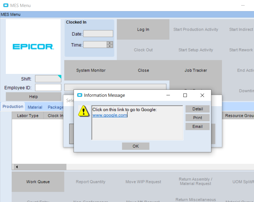

Thanks for everyone’s replies! I learned a lot from this post! Ultimately, it was another post that cleared it up for me. I ended up using a customization on the MES ShiftSelect form. Thanks to @utaylor for the answer in this other post! :slight_smile:
