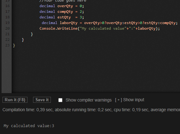

if your second priority -when not null- is estQty over compQty then your line should be:
decimal laborQty = overQty>0?overQty:estQty>0?estQty:compQty;
Thank you’ve updated it now :smiley: Still trying to work out this case when now! I love learning C#
