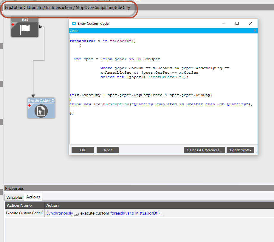

C# BPM help needed - Stop Over completing quantity on an Operation
My goal is to stop allowing users to over complete labor quantity. For some reason this BPM is triggering anytime the LaborQty is greater than 1.
What is wrong with my code?
foreach(var x in ttLaborDtl)
  var oper = (from joper in Db.JobOper
             where joper.JobNum == x.JobNum && joper.AssemblySeq == x.AssemblySeq && joper.OprSeq == x.OprSeq
             select new {joper}).FirstOrDefault();
if(x.LaborQty + oper.joper.QtyCompleted > oper.joper.RunQty)
throw new Ice.BLException("Quantity Completed is Greater than Job Quantity");
Because it is writing to the labordtl table. So any labor transactions will fire the bpm
InfoMessage.Publish($"x.Labor qty is {x.LaborQty} . oper.joper.QtyCompleted is : {oper.joper.QtyCompleted } .  oper.joper.RunQty is :{ oper.joper.RunQty}");

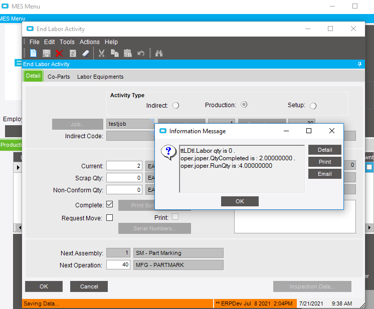

I had to click OK like 6 times when ending activity. so i assume that means that its doing an Update to LaborDtl that many times?

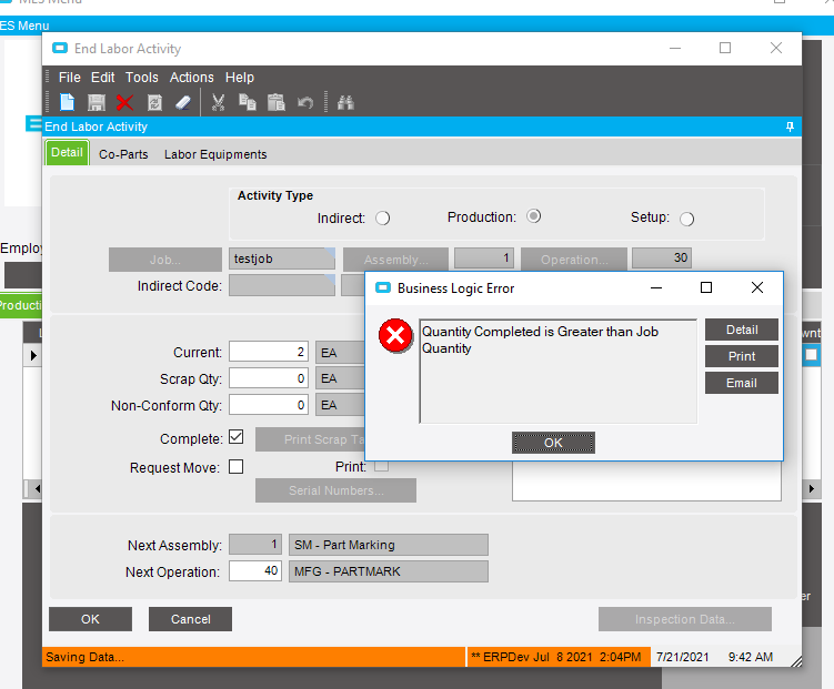

When i add the error message to @timshuwy 's code I only get 1 pop up message, but it still errors out. Any thoughts?
The comparison is probably failing and giving you a false with the .any. If you look at what’s coming out in the message boxes, it looks like LaborQty is an Int and the others are decimals, so I would guess it’s a type issue. Make sure you case all of those fields as decimals to make sure it evaluates correctly.
I just tried it with a quantity of 1 and it went through ok, it did do 4 pop ups though.
Would that rule out a Type issue?

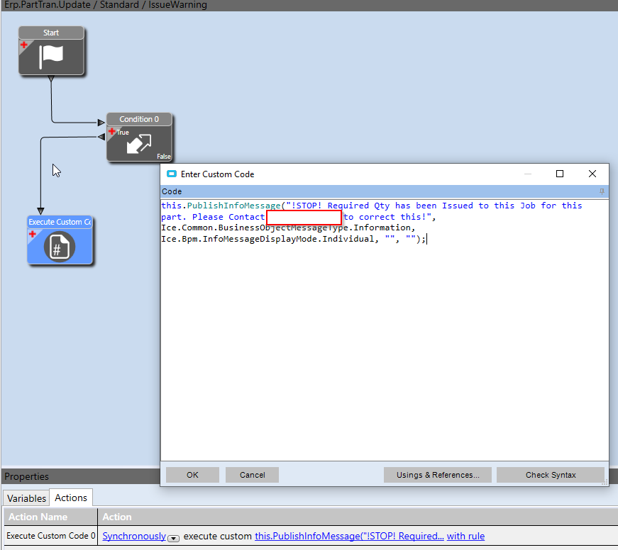

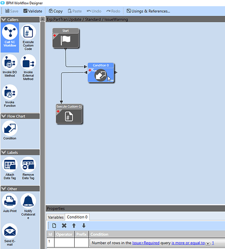

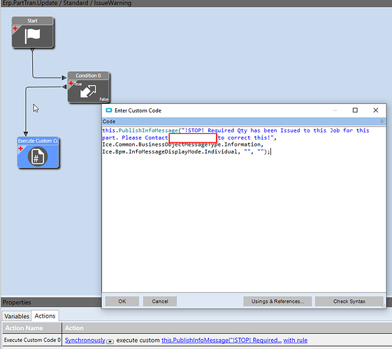

I made something similar for Issuing Parts to Jobs. Seems to work ok as a warning and still lets them proceed.

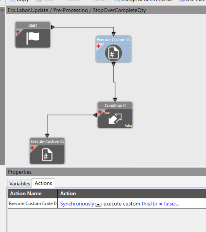

Trace log shows that the only method making a change to the LaborQty was Update.

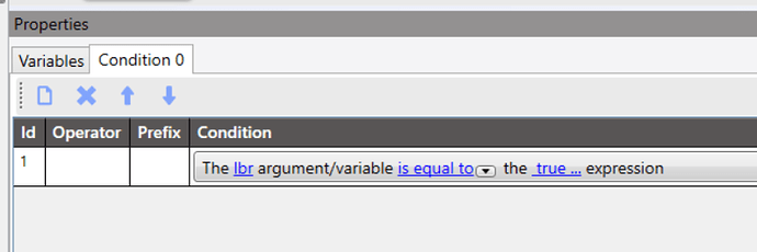

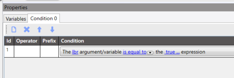

I created a BPM on that method using a bpm variable to limit when this is fired.
this.lbr = false;
var caller = callContextClient.AssemblyName;
if(caller.Contains("EndActivity"))
var lb = ttLaborDtl.Where(x => x.Updated()).FirstOrDefault();
if(lb.LaborQty > 0)
    lbr = true;
then using Tim’s code for the exception check
