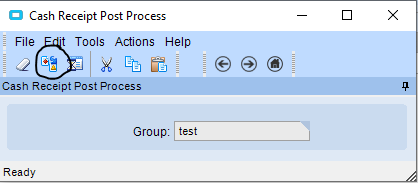

That is weird, does your BPM fire when this button is pressed?
And no I haven’t yet, I’ll look into it now.
It fires once the group goes through the posting engine. Have you also checked to see if the group successfully posted?
Yeah that’s what added to my confusion. The invoice, cashhead and cashdtl records would all become posted, but without my BPMs firing. So it sounds like it might be something specifically wrong on our system.
