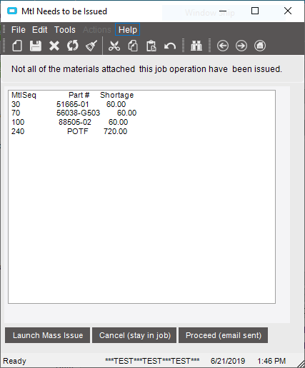

In my project to convert a screen customization to a BPM workflow, I’ve got another question?
I have this code to create a formatted string and assigns the string to callContextBpmData.Character01, which I’m displaying in a BPM form, which is sort of working, but I would rather have the data in an EpiUltraGrid. Is that possible?
Related questions is it possible to launch Mass Issue with the job/asm/opr prepopulated via code?
LINQ Stringbuilder code

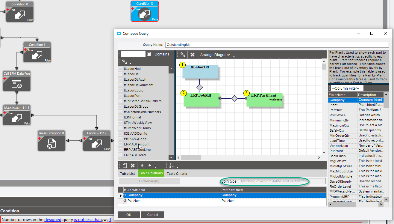

I’m using the LINQ code as a condition as well, basically checking to see if there are any outstanding mtl, if not proceed normally, if there is display the BPM form showing the mtls and options.
So can you not do left joins in a BPM query condition? It’s grayed out…
You should be able to…
You CAN do left joins in a BAQ, but it is not possible in a BPM Query… this is a long-time missing feature.
Well that stinks… Thanks for verifying @timshuwy!

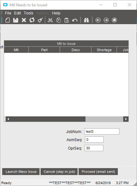

The Code I have is below. It seems to create the view correctly and bring in the BPMData values
public void CreateMtlListBAQView()
	baqViewMtlList = new BAQDataView("OutstandingJobOpMtls");
	oTrans.Add("OutstandingJobOpMtls_BAQ",baqViewMtlList);
	EpiDataView edvBPMdata = (EpiDataView)(oTrans.EpiDataViews["BPMData"]);
	string sJobNum = Convert.ToString(edvBPMdata.dataView[edvBPMdata.Row]["Character01"]);
	int iAsmSeq = Convert.ToInt32(edvBPMdata.dataView[edvBPMdata.Row]["Number01"]);
	int iOprSeq = Convert.ToInt32(edvBPMdata.dataView[edvBPMdata.Row]["Number02"]);
	txtJobNum.Value = sJobNum;
	txtAsmSeq.Value = iAsmSeq;
	txtOprSeq.Value = iOprSeq;
	IPublisher pub = oTrans.GetPublisher(sJobNum);
	if(pub==null)
		oTrans.PublishColumnChange(sJobNum, "MyCustomPublish");
	if(pub !=null)
		baqViewMtlList.SubscribeToPublisher(pub.PublishName, "JobMtl_JobNum");
Any pointers, I’m sure I’m missing something.

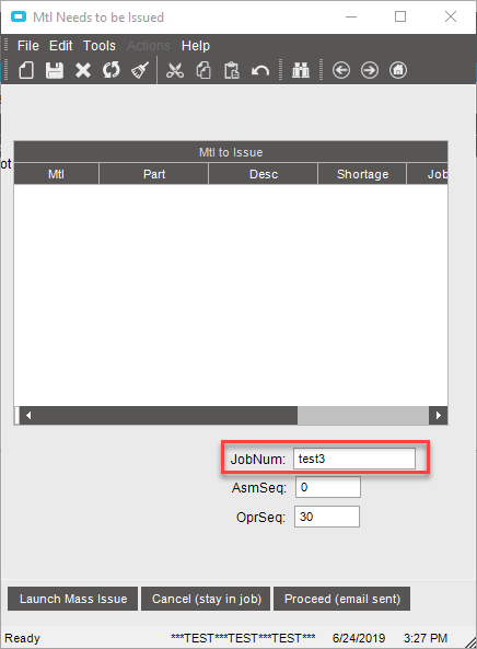

I’m calling it on InitializeCustomCode(), I’m 99% sure there is data because I’ve displayed the value of BPMData.Character01 in txtJobNum.

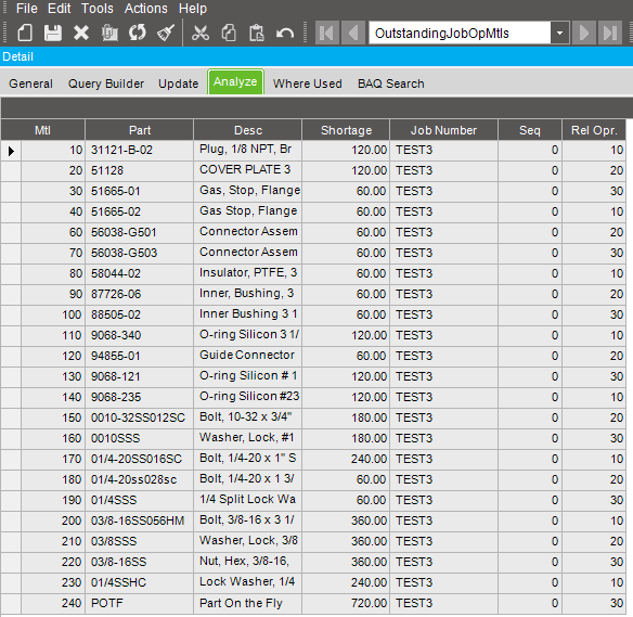

If I manually add the JobNum as criteria to the BAQ I get data when I test the it.
If I comment out the publish & subscribe lines of code, so I’m just creating the BAQview, the grid still has no data. Shouldn’t I get all of the data that I get when I test the BAQ?
Got it, so because this is a special IP form you may have to trigger it to change the value
What happens if you change that value on the textbox?
Yes, that did refresh the BAQ and it display the correct data. Is there a way to do that programmatically?
