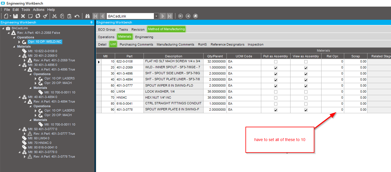

For those of us that import BOM’s, then add operations, it would be nice if there was a button or menu item to relate all materials to the first operation. Currently I have to go down the list and set each one, and every time you change lines, it goes through a save. That makes large assemblies take a long time.

I was just thinking that since when you paste in materials, it automatically defaults to the first op, a button to do the same thing would make sense.

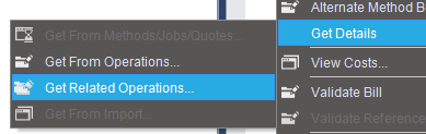

I made something in the past that works like Get From Operations… but instead it syncs from a previous Group ID… this above is a poor example because I picked 2 random ones and it failed to relate any… but definitely should be on Epicor’s Radar, plus it runs 50x faster than paste/update.
Because sometimes you have a Revision and you added or removed a few operations… and the user typically had to manually re-assign like 200+ materials… So I created a “lets sync from a selected GroupID” what we can, and what we can’t hilights yellow requires manual intervention or it defaults to 10.
