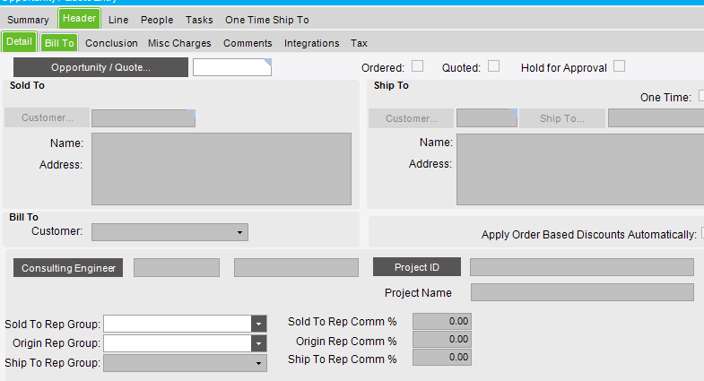

So current state has the Ship to rep group(Character10 in UD table) being populated based on the ship to zip. I am needing to add the sold to rep group(Character11 in UD table) which needs to be populated based on the sold to zip. I am new to c# so am trying to link all of these up.

So with this code you wrote. What would be the code to set Character10 in the QuoteHed_UD table to look up the soldtoZip from Ice.UD05.Key3 and grab Ice.UD05.Character01 and set Character10 to Ice.UD05.Character01 which would be the sold to rep group. UD05 is the table that hold the zip codes with the rep group for reference.

End goal is to populate Quotehed.Character11 with the same code as the original but instead of looking at the ship to zip code to get the rep group from UD05 it would look at the sold to zip code to get the rep group from UD05. I hope that is more clear. I am new to C# so deploying this with custom code is new.
