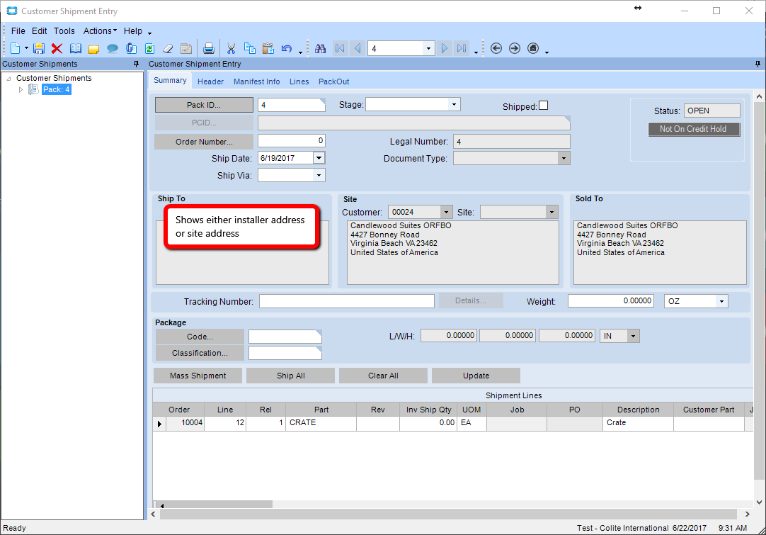

Good morning experts! I’m hoping someone can help with this, it seems like it should be simple but I can’t get it to work. I am customizing the Customer Shipment Entry form because we mostly ship our product to an installer, who then delivers it to the site for installation. For this reason I have changed the existing “Ship To” group to “Site” and created a new ship to area to show either the installer’s address or the site address. I’ve got the code worked out to show the installer address if the product ships to installer, but can’t get it to show the site address if it ships directly to the site.
I’ve got the code in the “oTrans_adapter_AfterAdapterMethod” event, under “POGetDtlList”, which is the last thing triggered before the data shows on the form.

It would be nice if I could simply say the Ship To TextBox.Text equals the Site TextBox.Text, but since the data loads after the “POGetDtlList”, that only results in a blank TextBox.

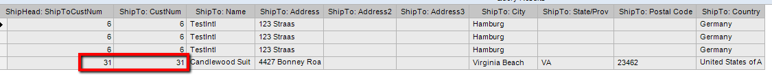

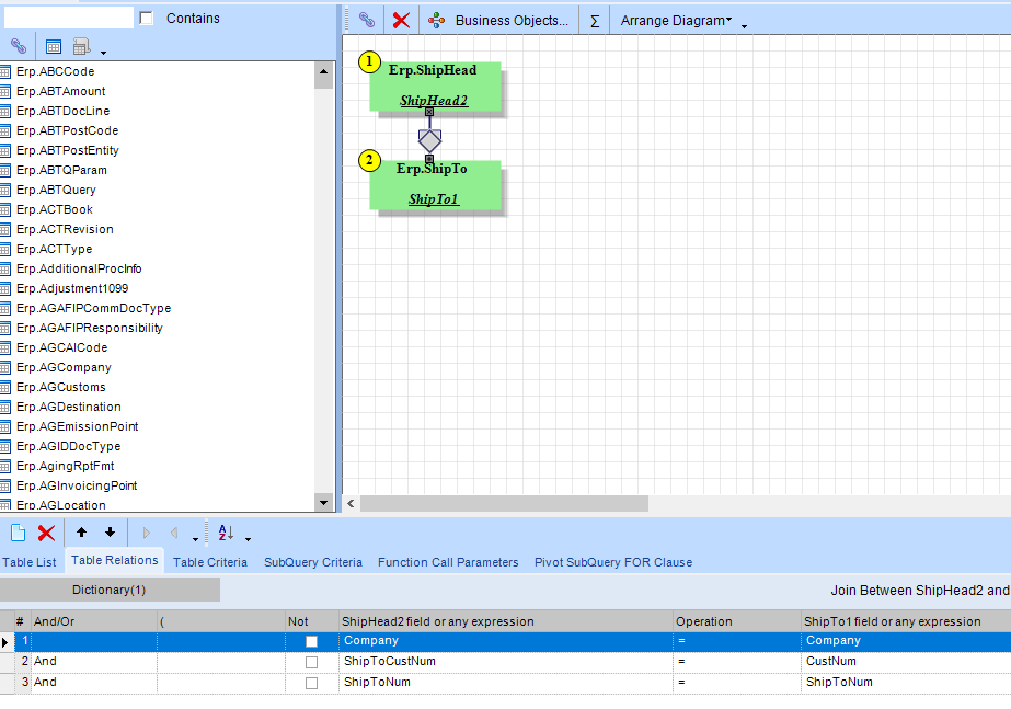

I create a BAQ with ShipHead and ShipTo…
The results show that there is a CustNum of 31 in the ShipTo table…
Can’t understand why I’m getting the error.
