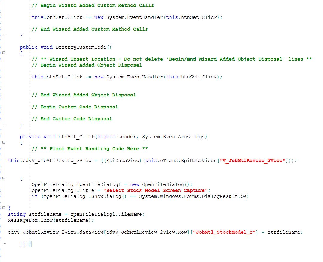

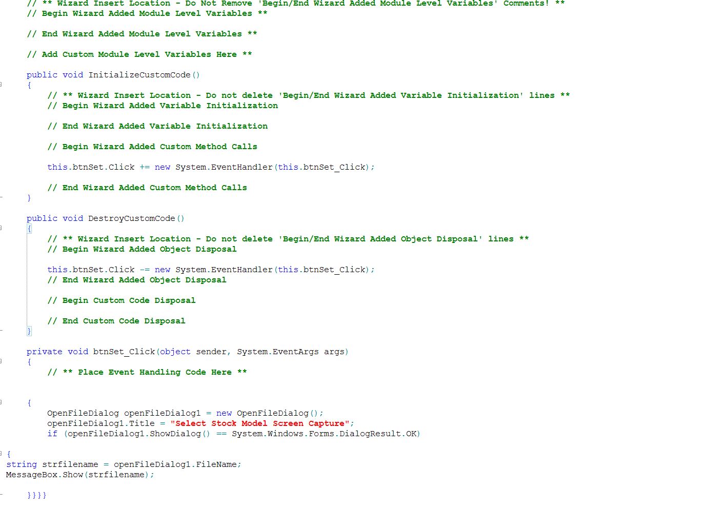

Basically, what I am trying to achieve is the browse file functionality then to paste the selected file path into the stock model file path field :blush: . (Field name = JobMtl.StockModel_c) / EpicTextBox1.
I am able to retrieve the file path however getting it back in to Epicor seems to be my problem :frowning:.

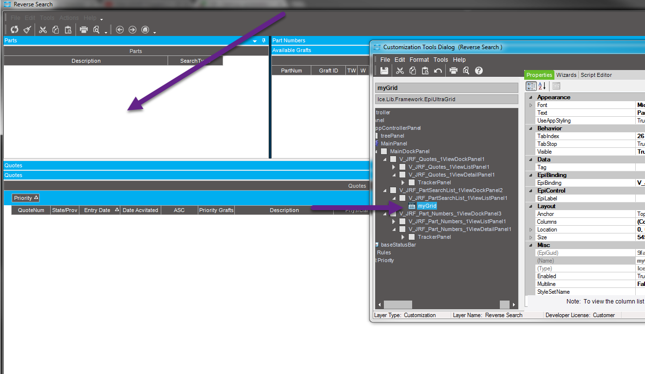

You’re almost there. So you returned your file path string from your open file dialog but now you want to place that string into a field within one of your panels, correct?
First, find the name of your panel within the Tree View of the customization dialog.
Next, you will want to find the EpiBinding of that panel. It will be bound to a dataview.
In your method, create an EpiDataView object form that points to that dataview:

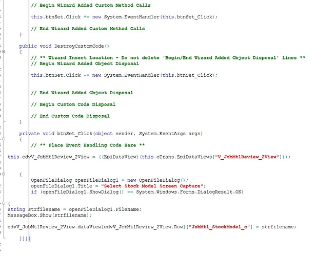

EpiDataView edvPL = (EpiDataView)oTrans.EpiDataViews[“V_JRF_PartSearchList_1View”];
To set the value of that epidataview field, you will want to know the column name from the BAQ that corresponds to that field. In this example, my dataview column is bound to the Part.ShortChar01 field from my BAQ.
edvPL.dataView[edvPL.Row][“Part_ShortChar01”] = strfilename;
Give that a shot, it should work!
Absolute hero Aaron - Managed to get it working thanks to your help :slight_smile:

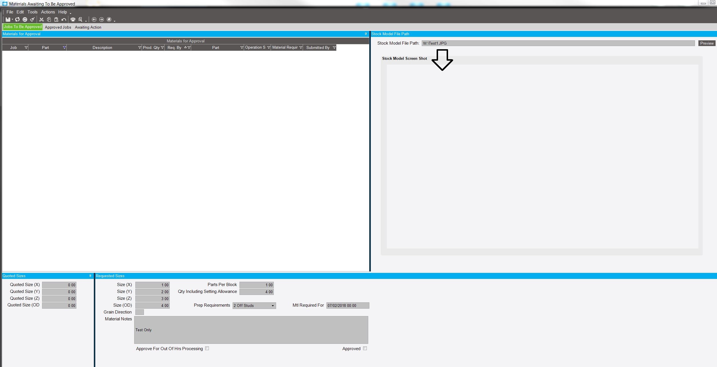

Hi All,
Off the back off this I was trying to achieve pulling the file path from the stock model field to display the image in the screenshot box, however I have had a go at it but with no luck so far. Hopefully someone might be able to point me in the right direction ?
