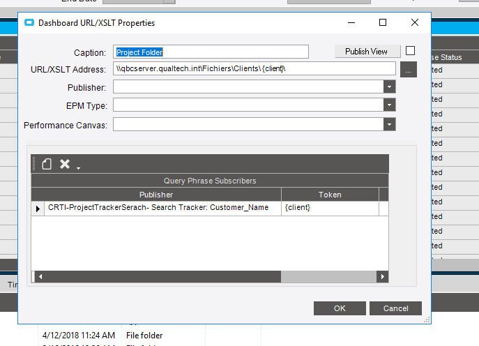

Thanks but I just tried:
\servername\Fichiers\Clients\ {client}
And the token has Customer_Name as the Publisher but when I refresh everything, it doesn’t work even if the folder exist on the network. Seems hard to find the problem, any way to alert/print the URL used somewhere?

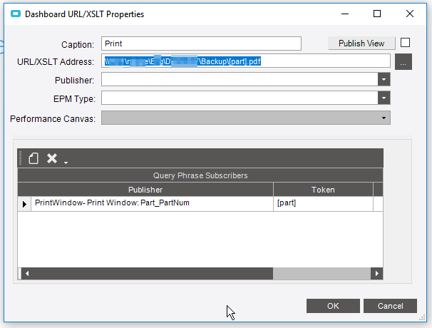

This is what I have set up to look at PDF’s
I pretty much puth the windows explorer in this so i want it to open a folder. It works great for my base folder but I want to dig deeper into the client folder and then the project folder later.
I replaced the {} with [] (guess my vision isn’t perfect :slight_smile: ) and it worked !!!
Thanks a lot, it’s working really great and way easier than I thought
I didn’t know if that would matter or not. Guess it does. Learned something new.
Sorry for that, I think I replied too fast and I guess I clicked on the folder by accident. It’s not working :frowning:
do you still have the \ at the end? I don’t think you need that.
I removed it. It works when I update my URL but if I select another project in my dashboard and I refresh the page, the explorer (URL) doesn’t update

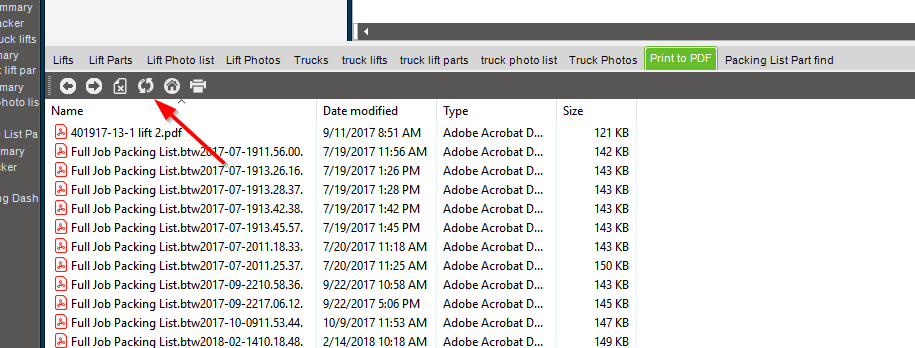

What happens when you hit this refresh? (I should ask which refresh are you hitting?)
I’m hitting the refresh on top and the refresh all button. If I clique on refresh IN the URL tab it just refresh the current folder
