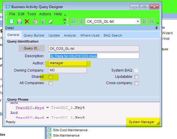

A user created a BAQ and didn’t check the Share box. I, as a security manager, cannot see it in the search window. I want to know if there is any way that I can access/see it. Thanks.
If you know its baq ID, just type that in the field in an empty BAQ designer form. You’ll be able to see it, but can’t change anything.
The first picture shows a BAQ created by user ‘manager’, which is not shared. This window was when logged in as ‘manager’.
The second is when user ‘ckrusen’ launches the BAQ Designer, and manually (or via Copy and paste) enters the BAQ ID.
But it does look like you can change the author. Below is when user ‘ckrusen’ loads a non-shared BAQ created by user ‘manager’
