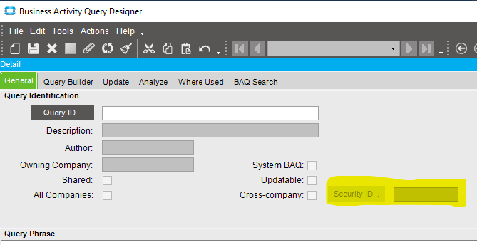

I believe you can accomplish that using the security button on there. You will need a security group that only has you two in it.
Yes, as @Craig mentions, it must also be shared.

I am going to assume that is available only on 10.2, I’m still running 10.1.500
Gary
I could of sworn that it was in 10.1.500.x I know it wasn’t available in 10.0 though
It’s not. When I saw Mark’s post I went and checked because I have a few places it would be useful. But I’m on 10.1.500 as well and it’s not there.
That’s my 10.1.600 screen so it appeared somewhere in between… Sorry!
It is available in 10.2.600 which I am testing
