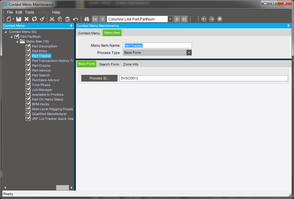

Take a look at your context Menu Maintenance
That’s where the “right click” functionality comes from.

Turns out I can’t do the Open With option either and I have full access. We can access the Part Tracker through any of the menus that have different Menu IDs just not with the Open With option, which would be SVGO0013. How would I go about checking security on a menu item that doesn’t show up in Menu Maintenance?
I see the same Context Menu Maintenance you posted.

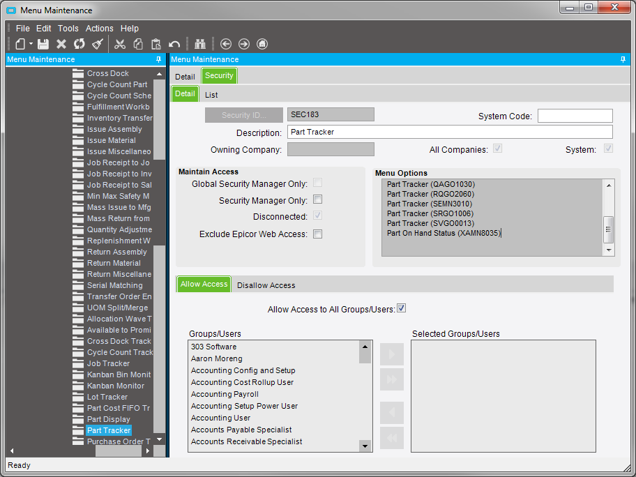

On one of the part Trackers in the menu maintenance, do you see this view?
Is it selected “Allow Access to All Groups/Users”?
You might want to also check the security on Executive Analysis. I have security on Executive Analysis but I allow all users access to the trackers folder within
