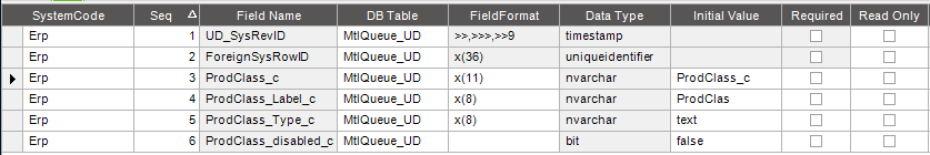

Created the 4 new fields and data regen has been performed. They fields do not show up on the handheld.

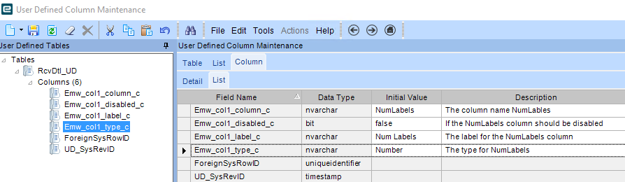

can you provide a screenshot of the table/fields.
Yes
When you set up the fields, they must match the documentation exactly and they are case sensitive.
Example:
Emw_col1_type_c
