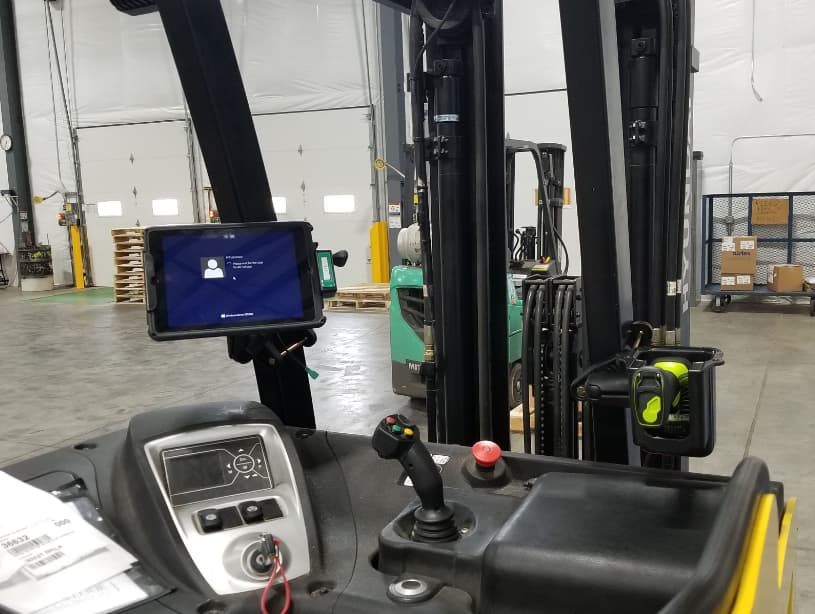

We use ipads that use the RD client app to remote onto a windows server remote desktop.
Most of our ipads are mounted to lifts with ram mounts that buzz around the shop floor. These are paired with a extended range 2d barcode scanner and usually have some quick barcodes for a ‘tab’ and other key information that might be useful in barcode form, so our lift operators don’t have to be touching the screen too much. They work pretty good, price was right, and have been reliable.
Some shop leads also carry ipads to use the same way.
Thanks, Tyler. I appreciate the feedback. I will pass this along!
And the iPads will run Kinetic in Safari when the time comes…
