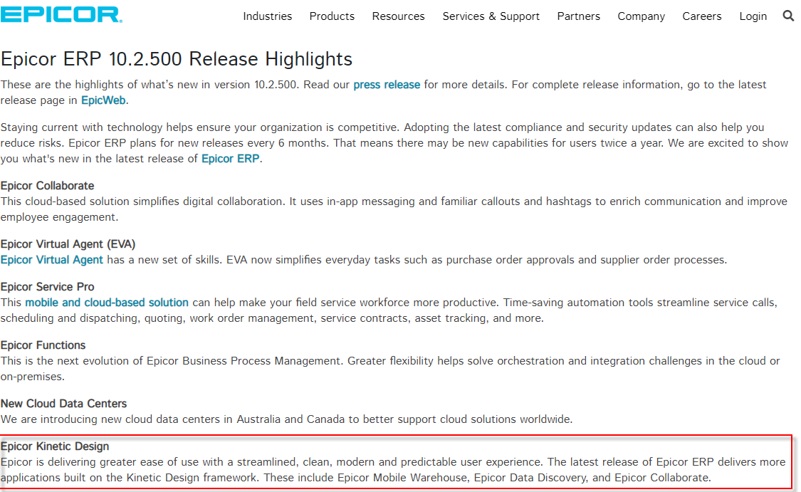

Epicor says that it is Kinetic in their release highlights for 10.2.500.
Yeah but it will not be Tailorable… (this new nomenclature is gonna be the death of me) until after 600+
