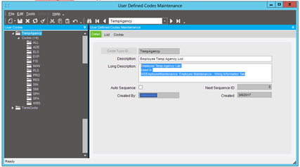

1.) Create a Code Type ID in the User Defined Codes Maintenance Form.
(User Codes can be found in System Setup – System Maintenance – User Codes)
2.) Add list of CodeIDs and Descriptions. (All the items you want in your drop-down list.)

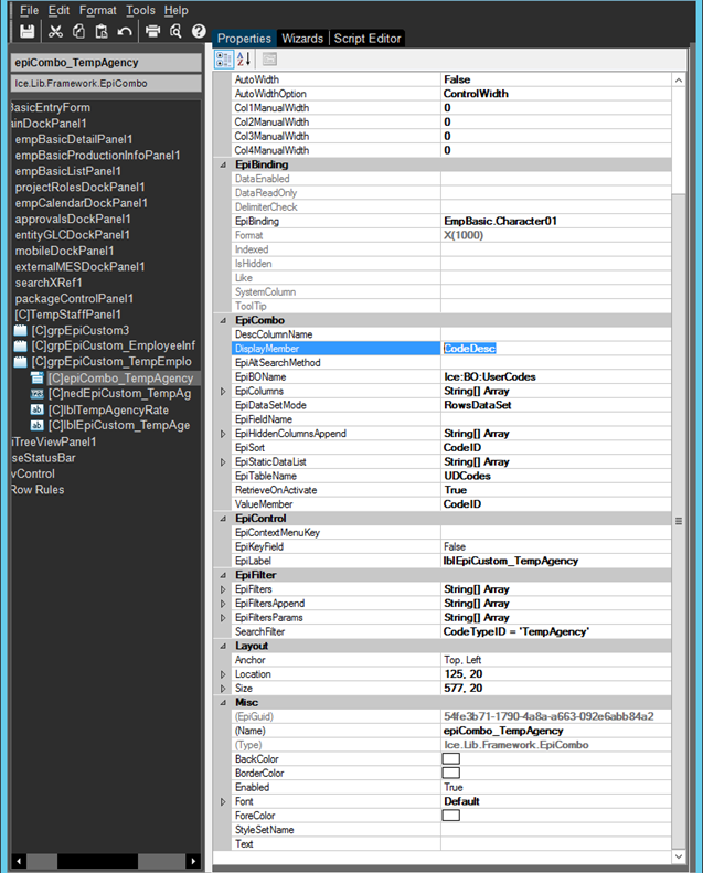

4.) Open up your Form Customization and make sure the control field that you want to use to point to the UDCodeType is an EpiCombo in the Type field and make sure Table.Character01 is in the EpiBinding field. Run the Customized form and hopefully you will see your UDCodes list from the newly created UD Code Type.

Here is my UDField/UserCode Field Settings and I see only the Descriptions in my drop-down list:

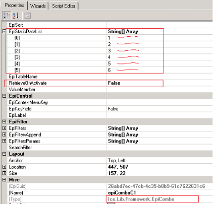

As others have stated, UD fields are probably the best solution.
In some cases I have used static values by editing the combo properties
  • uncheck RetreiveOnActivate
  • edit the EpiStaticDataList
  • set your UD field in EpiBinding
