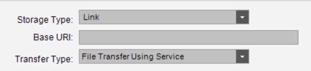

@jtownsend - Our storage type is just ‘Link’.

In Attachment Type Maintenance, what is your Transfer Type set to?
File Transfer Using Service
I am starting to wonder if the Attachment BO doesn’t trigger if the storage type is “Link”
That would make sense. You’re not actually moving any files. We used to use File System to push everything to a dedicated file server. Wouldn’t that fix your issues too?
It would, but then we run into permissions issues, which is a whole new can of worms as we are a government contractor.
