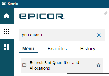

Also you could try running the refresh
Thanks everyone for the ideas. I dumped everything over to PILOT and tried the refresh and it worked. Seems like the kind of thing to run at night on Production. Thanks Randy.
