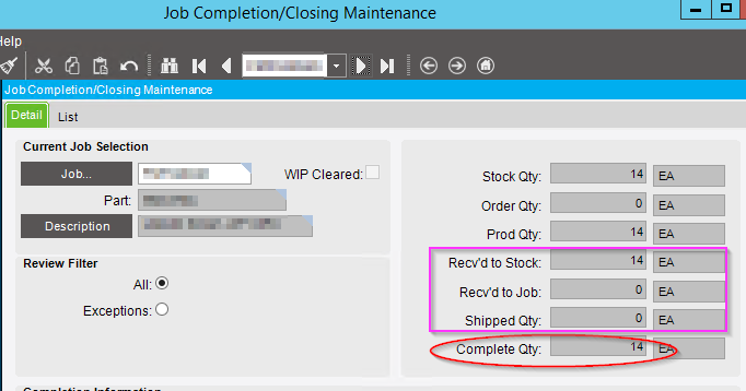

Yes, you should be ok if you simply leave the job open… Note that on the Job Closing process it tells you if there are open items… The quantity complete (red circle) tells you how many parts you completed on the job… the quantities inside the pink box is telling you how many finished parts have been relieved from the job by either Receiving to stock, to another Job, or by shipping (as would be the case in a Make Direct job).
Any time there is a quantity complete, but not received/shipped, and you close the job, you will cause problems. Some people try to close everything without fully examining this screen… but that is why we have this screen. For you to make sure that everything is done. to verify that all materials are issued, all labor is charged, AND all finished items are received/shipped.
