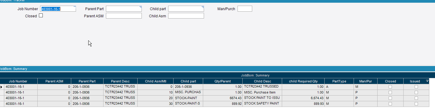

edit: Here’s a BAQ that we use to look up parts by job. We have it in a dashboard (pictured below) that we use all of the time to find what parts are on jobs. The overall dashboard is huge, so I won’t export that, but the query should get you close. It’s a union query that puts together the Job Materials and Job Assmeblys in one grid so it’s easier to search.
JobBom.baq (41.9 KB)

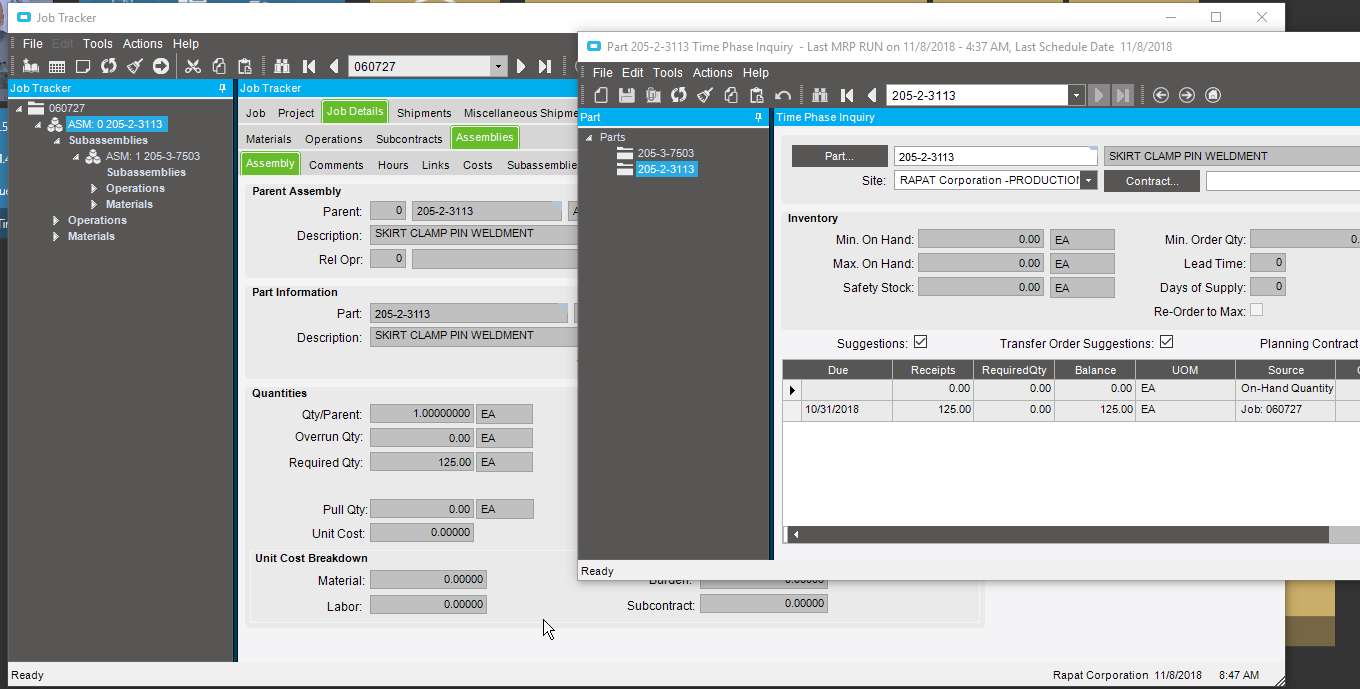

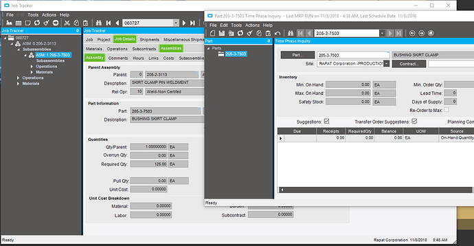

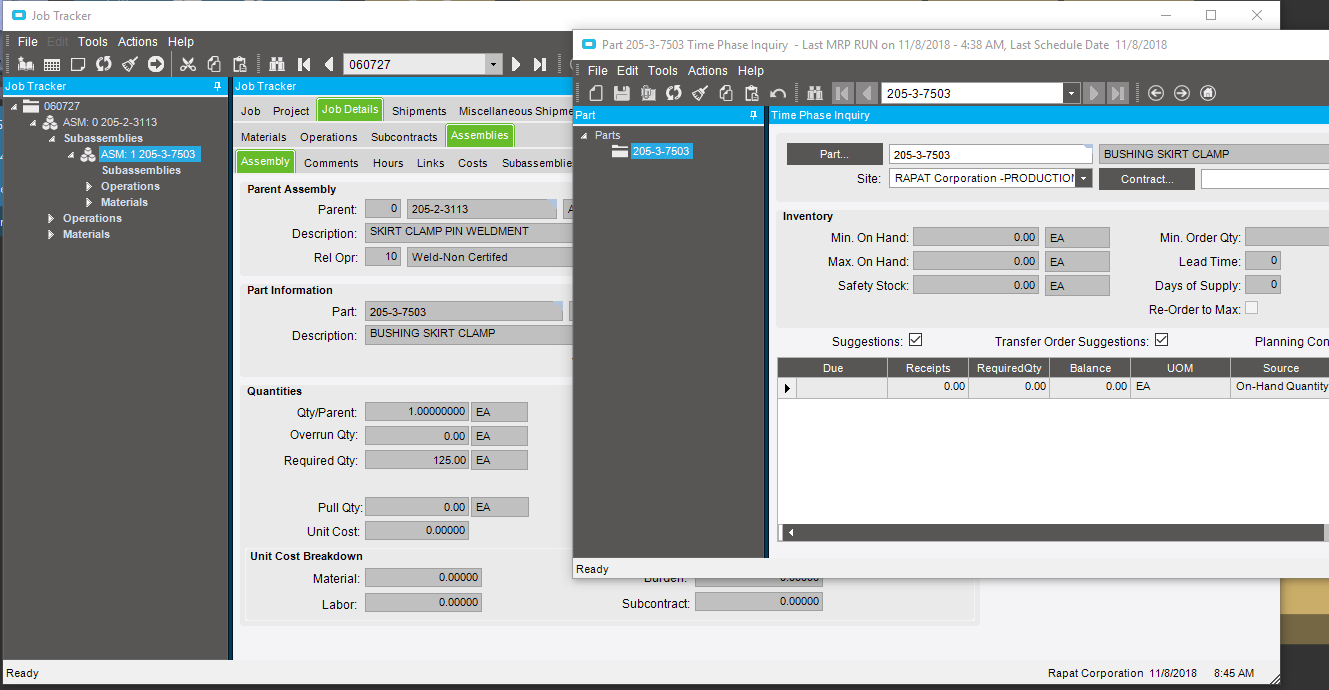

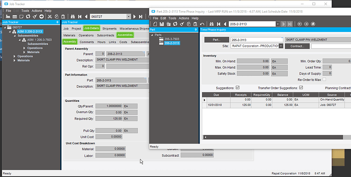

I meant to answer this a little better too. Calvin you are correct, here is an example. The part I show here is a middle level pull as assembly part. You can see in the time phase that there is nothing showing for that part.
The top level shows in time phase for a receipt on the job. This is the only assembly that will show in time phase because it’s what the job is for.
So if the part in question is a mid level assembly, you need a BAQ to find it. I don’t know of any Epicor native screens that will look for those parts. Does anyone else?
