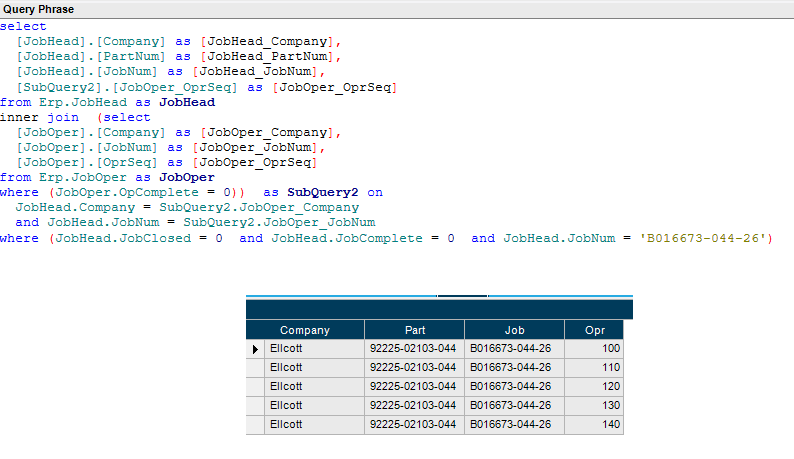

Hmmmm… I see what you mean. The “TOP” setting on the sub-query seems to affect the overall BAQ, and not just that subquery’s results

Still getting 0 rows as a result. This is supposed to be simple LOL just give me the top record. Here is the query if it helps.

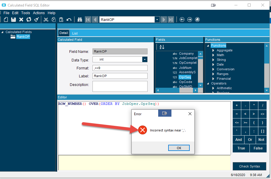

I always use Row_number in a calculated field of a subquery, and calling it rank. I was as well, never successful at using top options…
ROW_NUMBER() OVER(PARTITION BY //here you put your group by fields// ORDER BY //here you put the order by fields// ASC))
Then add a condition on the subquery added to your top query, to only retrieve the rank = 1

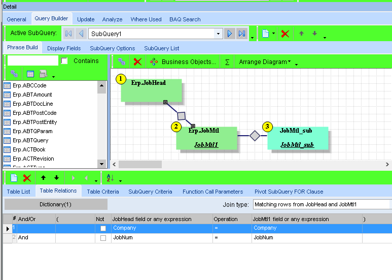

First off, in my examples, I’m using JobMtl wher you’re using JobOpr. Should work the same way.

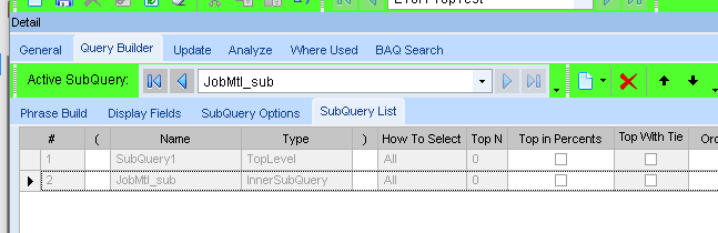

My BAQ has two subqueries. Both are set to return ALL records

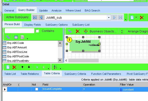

The subqry
JobMtl_sub, just has the JobMtl table, with criteria to only return the Mtls that are not issued complete
The subqry

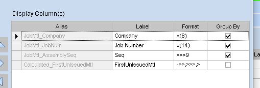

JobMtl_subhas columns
with the Calculated field being:MIN(JobMtl.MtlSeq) -

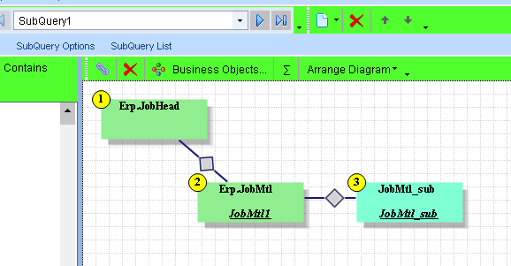

Top level subqry is:

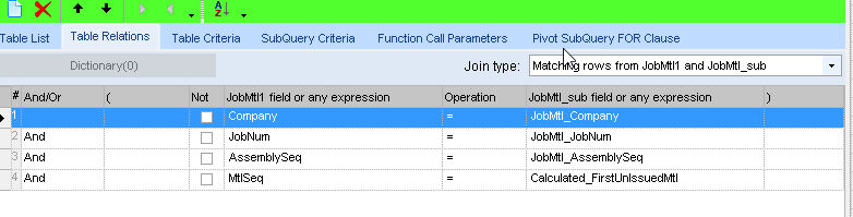

with the relationship between the JobMtl table and subqry JobMtl_sub being:

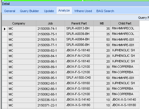

Here’s the output. I get only 1 Mtl Record per Job.

This worked I think what I was missing was to relate the OpSeq from the JobHead to the Subquery. Thank you so much
