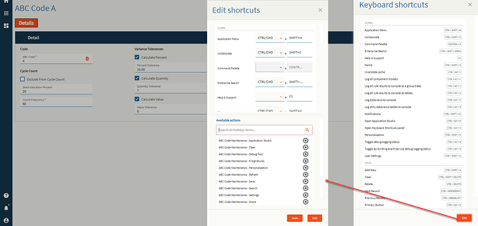

Best you can do is press CTRL+ALT+H and edit the key bindings.
No other way to capture key presses as far as I’m aware.
Is this a per user setting? Or will this be for the app?
