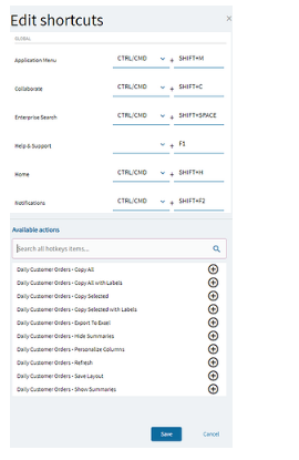

Check below options.
@fakhruddin - I am not seeing the same available actions that are in your screenshot. How do I turn on the shortcut to save the specific Kinetic window I currently have open?

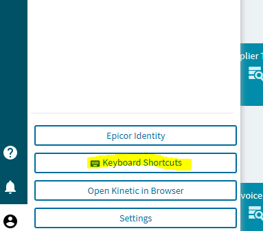

I found that you have to have the app open. So if you wanted to Save while working on Customer maintenance, open Customers, press ctrl+Alt+H to open the Keyboard shortcuts appl. Click the Edit button. The Available Actions search is activated at that point. Then find your action, click the plus symbol. The action is added to the Local list above. Then you can enter in what ever keystroke you want to use to Save.
