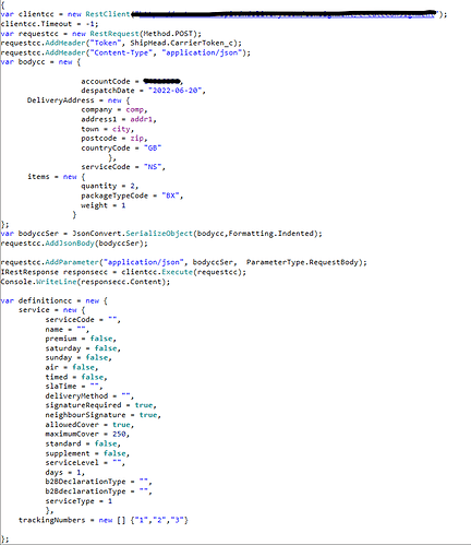

The below is my code (i know the trackingNumbers section is completely incorrect)
The SERVICE deserialization works perfectly but I’m failing on the bottom trackingNumbers section.
Any help here would be greatly appreciated.
Hi,
In this case do you want to deserialize the data you receive in the response, or send some data to the API?
The tracking numbers is an array:
trackingNumbers = new[] {"1","23","3"}

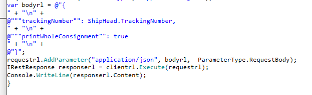

Speaking of sending some data, how would i send a field or variable to the api.
I currently have the below and i would like to submit the tracking number field from Shiphead but im not convinced this will work.
I do it like that:
var bodyrl = new {
      trackingNumber = ShipHead.TrackingNumber,
      printWholeConsignment = true
requestrl.AddJsonBody(bodyrl); // Anonymous type object is converted to Json body
I don’t think serialization is needed when using RestSharp

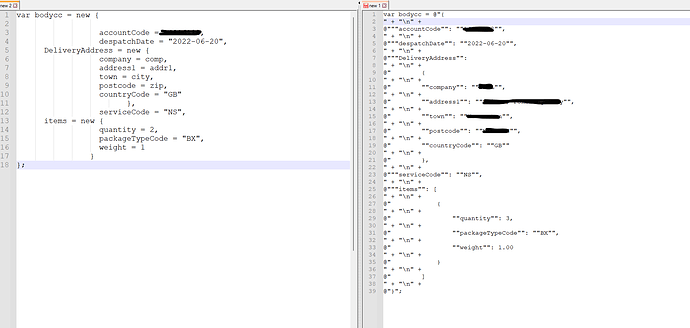

Sorry again, I’m having some real trouble sending address data to the API now.
The code on the right works fine but i cant dynamically change the address details.
The code on the left throws Json Deserialization errors and i cannot find why it is incorrect.
Any ideas?
Serialize the code on the left before sending it s hould work:
var bodyccSer = JsonConvert.SerializeObject(bodycc,Formatting.Indented):
Still throws the same error.
I couldn’t put the serialize code before setting bodycc as it had not been declared yet.
You serialized bodycc into bodyccser but still sent bodycc.
Pass the bodyccSer insead of bodycc
Thanks but I’m still getting the same error.
Event Viewer error from server is below.
Is this the whole code in this BPM ?
