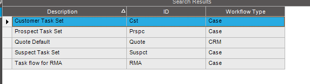

What about the task sets themselves… CRM or Case Management?
Task Sets relate to CRM,Case, or ECO if I am not mistaken so in order to use task sets with case entry you have to create the task set in the related area (CRM,Case,ECO).
I mentioned I was using case entry and case type so I have case related task sets.
