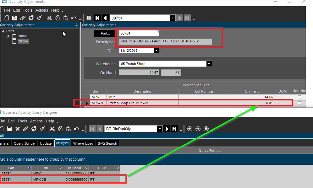

Is there a way to change the displayed decimal places in a system form grid view without replacing the grid? We have a lot inventory transaction issues with UOM changes that leave minor decimal amounts present in a bins and the system rounds them to 100th decimal making it difficult to transact them out.
I can get the exact amount through a baq and dashboard but it would be simpler to just adjust the grid views to show the full 8 decimal places in the qty adjustment form.
Al lot of grids will show the * when its rounded but the qty adjustment does not, and you cant hover the * in a grid view to get the exact number anyway.
You can change the on hand to read extra decimal by editing the UOM in setup but the grid values do not follow the same rules. At least in 10.0…
