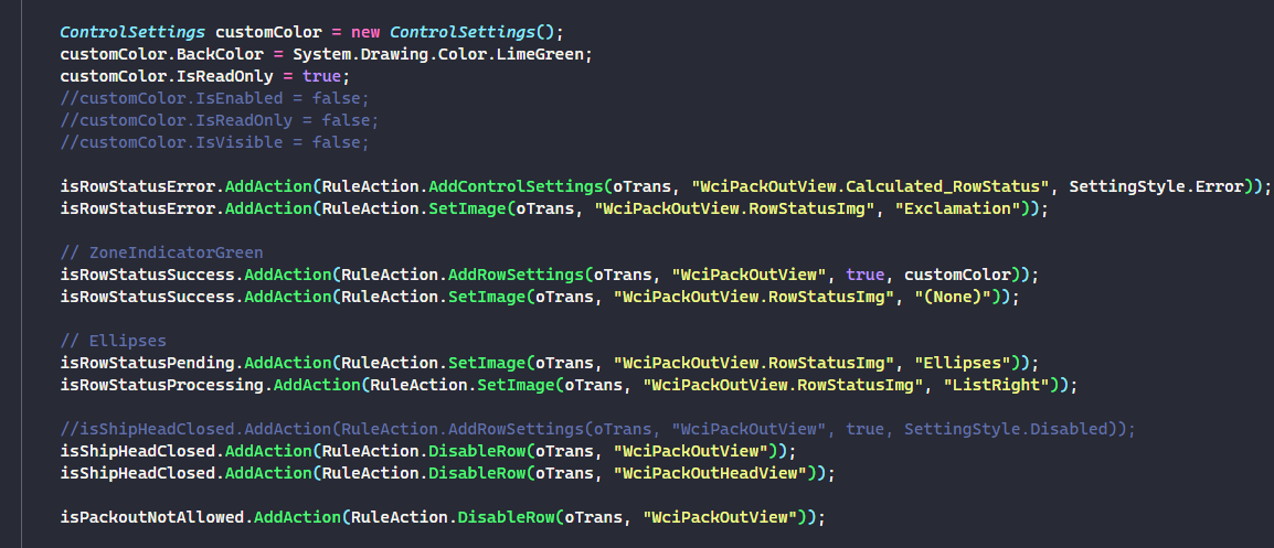

Funny, I was just doing a Custom Color yesterday, because @jgiese.wci loves LimeGreen and hates Epicors default Green :slight_smile:
Bonus
Maestro @josecgomez has a Video on it in his gentle cuban voice.
It’s not lime green it’s the Excel colors!
But also yes their default color schemes and color choices are often… questionable at best lol
Whatever customization you made lime green use Pixie (Pixie / Nattyware) color picker and fix it :joy::rofl:
For sure, your colors on the Dispatch Dashboards are like eye-candy to look at, even someone color blind would appreciate them :slight_smile: I agree those are good choices.
