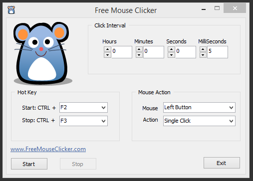

I went a different route, using my Free Mouse Clicker on my way out the door to lunch :wink:…

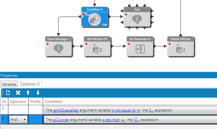

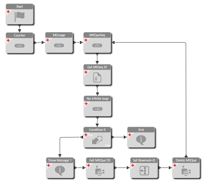

Thanks for help here fellas. I handled deleting the entries with a BPM that triggers off of PO Receipt UpdateMaster. It looks for any created Material Queues, and deletes them. Note that MaterialQueue.DeleteByID doesn’t seem to work. I used the RowMod = D trick.
Terry,
Any chance you can share that BPM. I’m looking to do the same thing.
Man this is one of the first BPMs I made, its pretty sketchy. Here is the custom code.
BPM:  Receipt.UpdateMaster - Delete auto generated Material Request Queue
Date:         23 May 22
Author:       Terry Raymond
Purpose:      Material transfer requests are automatically generated upon PO Reciept.  These are inconsistent, sometimes wrong, we've not used them.  But if these entries exist, it prevents a sales order from being shipped/closed.  BPM deletes any material transfer requests upon receiving a line to a packing slip.
Requirements: None
Help:
https://www.epiusers.help/t/clearing-out-material-request-queue/65482
https://www.epiusers.help/t/when-is-rowmod-required/69779
https://www.epiusers.help/t/force-rowmod-on-quote-order-lines/67356

And the condition:
Thanks, I’ll see if I can figure it out

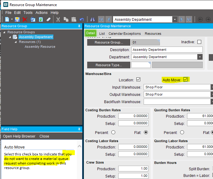

I just ran across this - These Material Request Queue entries are caused by the Auto Move checkbox not being selected. So just check that box instead of making goofy BPMs!
This is for when the shop knows to take items from one dept’s output to another’s input, without being told to do it by Epicor, nor having Epicor track that movement.
Gotta be kidding me - so “Auto Move” kind of means “Don’t do anything, someone else will move it”?
Or does it actually create the move transactions?
@SteveFossey Just do nothing. I have a few bpms that force this in case the user in an end activity or non conformance unsets it.
It assumes the person who ended activity is going to take the product to the next operation. We have yet to use the material queue for moving WIP. I could see it for a forklift operator or something in a huge facility but for a company with 100K SF and adjacent work centers, not a value added transaction.
