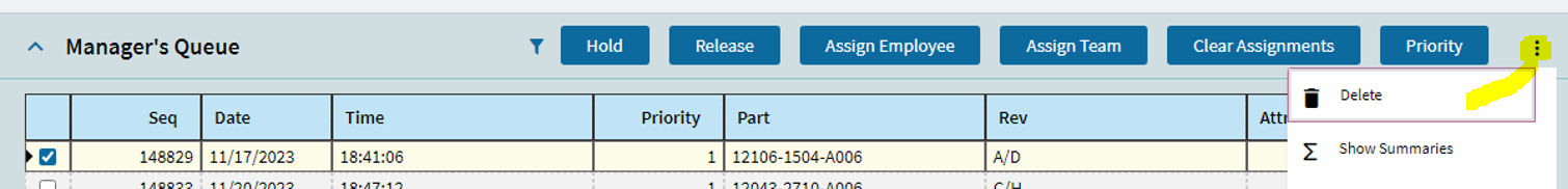

material queue manager. then select the queue in the overflow is delete.
Go to material request queue > filter > Enter Part > Highlight Row referring to that part > Delete
Then you should be able to process the RMA Disposition :slight_smile:
This is also one of very few places in Epicor where you can actually perform a mass delete via the UI itself. A delete here will respect a multirow selection.
