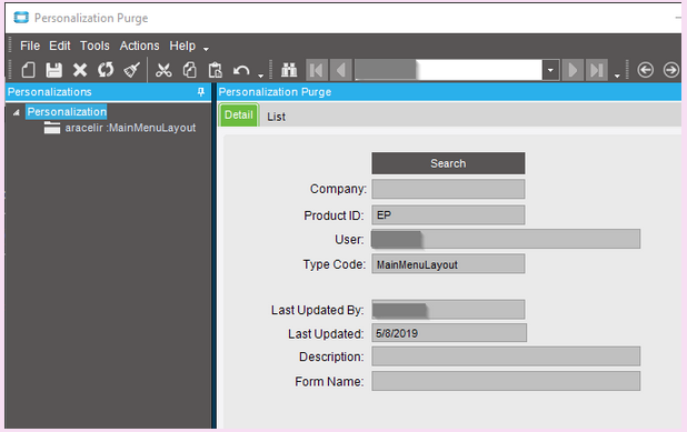

Not only can you delete Personalizations from Customization Maintenance but there is also a Personalization Purge where you might find a MainMenuLayout Personalization for these users that, once deleted, might fix their problem (like Calvin suggested!) :slight_smile: :

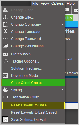

You could also try a (Shell: Home - Settings - Clear Client Cache) or (Classic: Options - Clear Client Cache)
Or a (Classic: Options - Reset Layouts to Base) ?

Thanks, Heather! I believe someone had him try to clear client cache but that didn’t change it. I talked to IT and they said that it may be something with the VPN.
