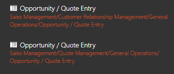

there are two different menus. Did you get both of them?
