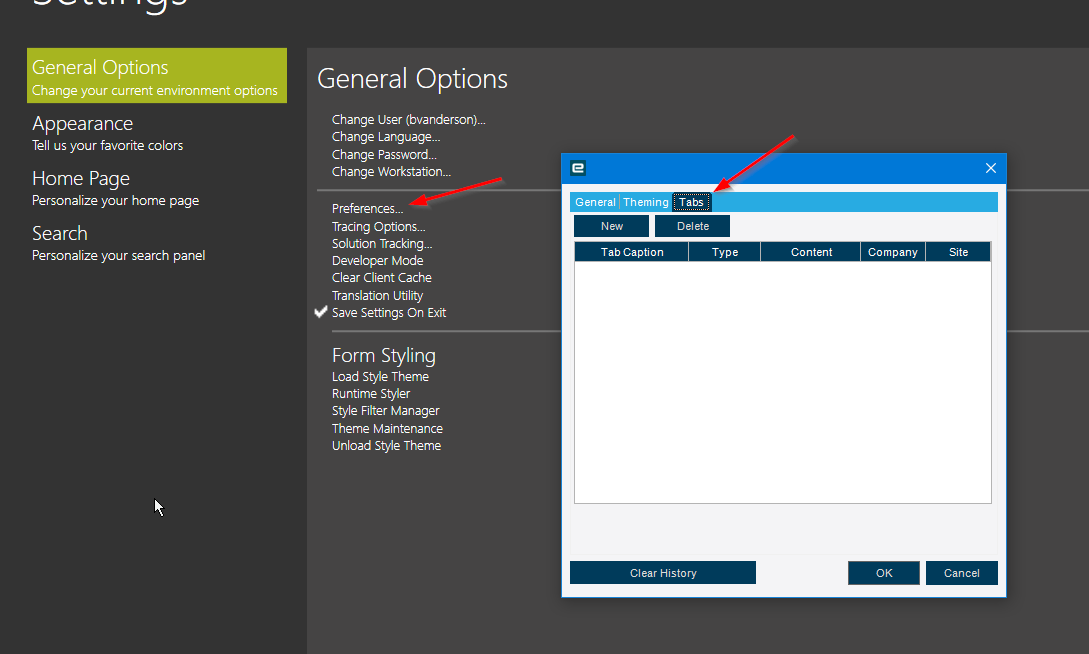

For one of the times you get it to work, can you look in settings, preferences, then check in the tabs tab? There is some intended use case to automatically open screens when the user launches Epicor, but it never really works right, and can cause problems like you are seeing.
I’m not 100% sure that this is it, but it could be.
That’s what the recommended was. We aren’t using Vista. Although there are times it might be an improvement…
So the issue has started again today. It had stopped but restarted. I checked the tabs thing @Banderson had recommended, but unfortunately that is not it.

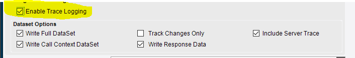

For those that come after, why this makes the difference I don’t know. Why it only causes issues every few weeks, I don’t know. But turning this off fixes the issue:
Under User Account Maintenance, Tracing tab:
Turning this off fixes the issue.
That’s a good catch. I did not think of that! Log files can get too large and or have something in in that corrupts your session. Really, you should only have logging on of you are actively trying to fix a problem. Glad you figured it out!
Tracing should only be on when you are actively debugging a problem. Most of us would have assumed it was off.
He’ll likely see a good speedup as well, depending on what the trace settings were.
I’m honestly not sure why it was even turned on for him as he wouldn’t know what to look at it in it. My guess is when he was set up, the person doing setup didn’t know what they were doing and since he’s the CEO, they just checked everything. There are a few other permissions that we’ve taken away simply because he has no reason for them.
