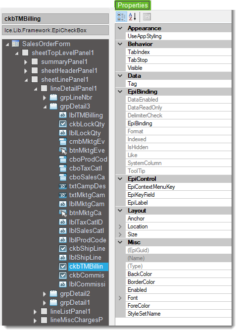

I’ve already performed this step. To be a bit more precise, I’m specifically interested in the behavior of the “ckbTMBilling” control on the Sales Order Entry form (Erp.UI.App.SalesOrderEntry.SalesOrderForm).
Trace log show nothing going on behind the scene after clicking on that control, on and off, three consecutive times, for a total of 6 clicks.
There are no properties that I can isolate related to that control’s value (true/false), or its checked “state” (true/false):

I can also address it from the Ice framework:
Ice.Lib.Framework.EpiCheckBox chk = (Ice.Lib.Framework.EpiCheckBox)ctrl;
… and try to modify its checked state:
chk.Checked = false;
The problem is that any attempt to modify, by custom C# code, the checked state of this control - the results never show up on the form.

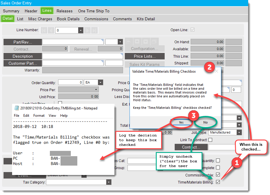

It’s more of this type of situation:
  1. User clicks on that checkbox
  2. Message box is presented to inquire if the user meant to place a check in the box
  3. User responds “yes”; conditional takes over and logs that confirmed answer, leaving the check in place – OR …
  4. User responds “no”; conditional takes over and clears the checkbox for them
It’s the last part in bold that I’m having trouble with.

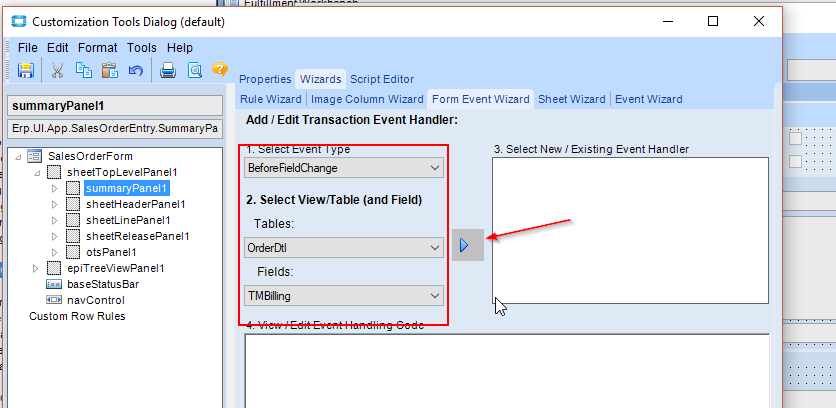

You can’t use the wizard for events of built-in controls.
Try a Form Event of type AfterFieldChange, for table OrderDtl
ok I have read more thoroughly what you are trying to do. In this case you should use the BeforeFieldChanged event in the data view. This is an event that is raised as soon as the change is made in the datafield (anywhere)
This will generate this code in which you can put your logic. The reason to use the “before” event is because the data hasn’t been yet committed and can be “canceled” via resetting the proposed value.
private void OrderDtl_BeforeFieldChange(object sender, DataColumnChangeEventArgs args)
		// args.Row["FieldName"]
		// args.Column, args.ProposedValue, args.Row
		// Add Event Handler Code
		switch (args.Column.ColumnName)
			case "TMBilling":
                                //Here check if args.ProposedValue == true then raise your message box, if they click No, set args.ProposedValue = false;
				break;

José:
Yes. That is how I originally set up this solution - through the form event wizard (code start shown here):
		case "TMBilling":
			if (Convert.ToBoolean(args.ProposedValue) == true)
				EpiDataView edvOrderDtl;
				edvOrderDtl = ((EpiDataView)(this.oTrans.EpiDataViews["OrderDtl"]));
				DataRow edvOrderDtl_Row = edvOrderDtl.CurrentDataRow;
I’m just checking to see if this checkbox “proposed value” is set to true at any time. If so, start processing some data validation assistance for the user.
Quick backstory – we’re having trouble with people clicking on this checkbox which places the sales order in an “on hold” status, as well as creates multiple invoices for the same order. This is a problem for us and we want to track it.
So… the intended validation flow is something like this:
Everything works… it will log the decision to leave that checkbox checked after forcing someone to acknowledge it. But - I can’t perform a simple “clear” of the checkbox if someone made a mistake and clicks on “No” to the acknowledgement message box.

EDIT:
I just saw the code notation you had referenced where it states:
Is this the direction I should be traveling?
The answer on that would appear to be “Yes”, because I just tested it.
That was the magic I was looking for… just clear the checkbox for the user.
This is why people like me get confused on addressing the data view in this specific type of situation. I do understand the data binding aspect of data views… but this did not seem to be a “data” function, in my mind (again… fractions versus base-10 mentality).
Thanks for being patient, José, Chris, Calvin… much appreciated. You guys pointed me in the right direction and I can’t thank you enough.
I’m setting José’s example above as the solution. For those reading this looking for answers - you’ll want to specifically focus on where José states in the CASE block:
// Here check if args.ProposedValue == true then raise your message box, if they click No, set args.ProposedValue = false;
What clears the checkbox control (in this specific situation) is:
